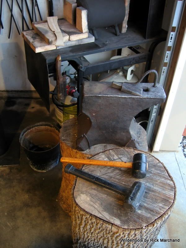

I use an ash log. Here is my set up...

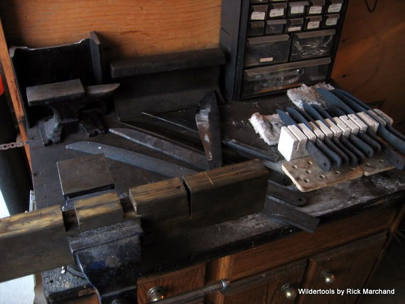

This is what i think Stacy is talking about...
Man Rick, you like your post anvil so much you even knock the horn of your regular anvil. ;):D
Yes, that is what I was talking about.
On your wooden anvil, just run the end of the "T" wooden anvil you made about 6" into a table saw, and then repeat with the fence moved a tad. This will make a 1/4" slot running parallel to the wood. You stick the blade tip in the slot and twist or bend as needed. If the wooden anvil is made from a solid 4X4, you can cut the slot crosswise, as Rick showed.

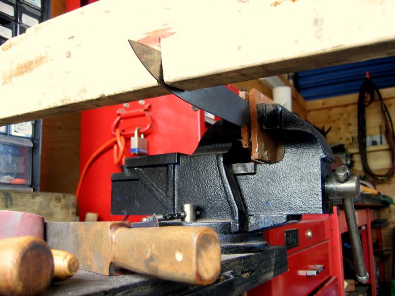

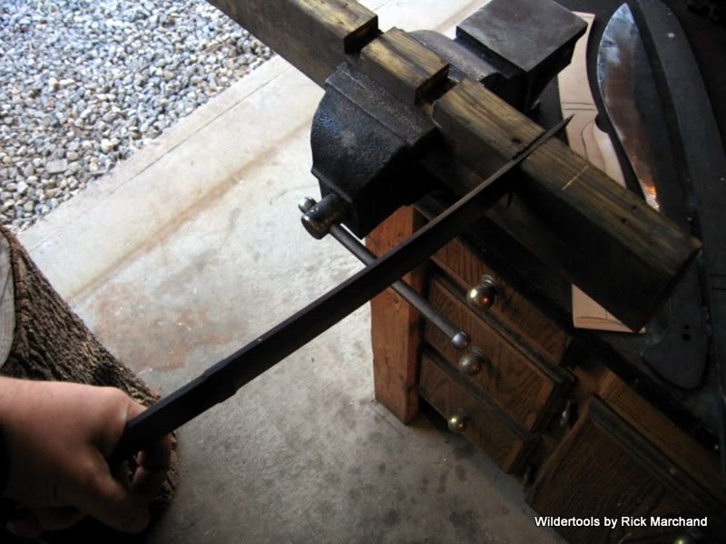

Here is another method for the slotted 2x4. Clamp the blade in the vice and use the 2x4 to bend/twist it back to true.
Warning: If using this method on hardened blades, place the 2x4 over the spine. The edge is too brittle and thin cross-sections will just flex under the strain with little to no plastic deformation(think fillet knife). Control the spine and you control the edge..... mostly.
And you can make a two piece set of those, with the slot on the end of each, to locally straighten and untwist blades. You place one slot on each side of the warp/twist and move the handles in-out or up-down as needed.
