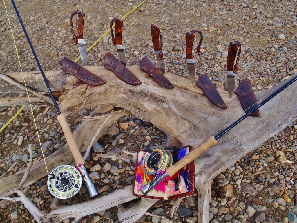

I collect custom knives but am also a hobby woodworker. I had the same desire, to use my woodworking to put nice wood handles on pre-made blades. I've "made" a few knives using blades from Jantz Supply and Texas Knifemakers Supply. The Jantz blade are made in USA and are high quality. Jantz has a good reputation and their customer service is great, in my experience. Last ones I did were S30V in the #36 pattern (photos below). I would highly recommend them. I've also done a few from TKS as they are in Houston. They were good but of the two I prefer the "hand ground" Jantz blades.
Very generous of Mr. Sanders to offer advice over the phone. If he disagrees with anything I said, trust him.
I gave these as gifts to my Alaska fishing buddies.
Also, although this is not the correct forum, I took dozens of WIP photos of this build. Nothing that would teach these old dogs anything but maybe something would help a woodworker finish a project knife. PM me if interested and I'll send or post over in the "shop-talk" forum. You can get a great deal of advice over there about what to do, and perhaps more important, what not to do.
I purposefully didn't answer your question about quality steel. That's better left to the experts to debate. All I can say is first decide if you want stainless or carbon. After that options are endless and Jantz had most types in stock. Maybe an easier question since your not going to be working it but just using the finished knife.
Beautiful knives! I like the matched bead on the lanyard, should be a snap to turn those on the lathe using a pen mandrill and add a really nice touch.
Those knives you have there are pretty much exactly what I had in mind, after a few test runs with walnut for practice I want to make 3 matched knives for my dad, brother, and myself out of some highly figured burl.

Those are the blanks I was going o suggest and you made them look super nice Mr. Schilling.

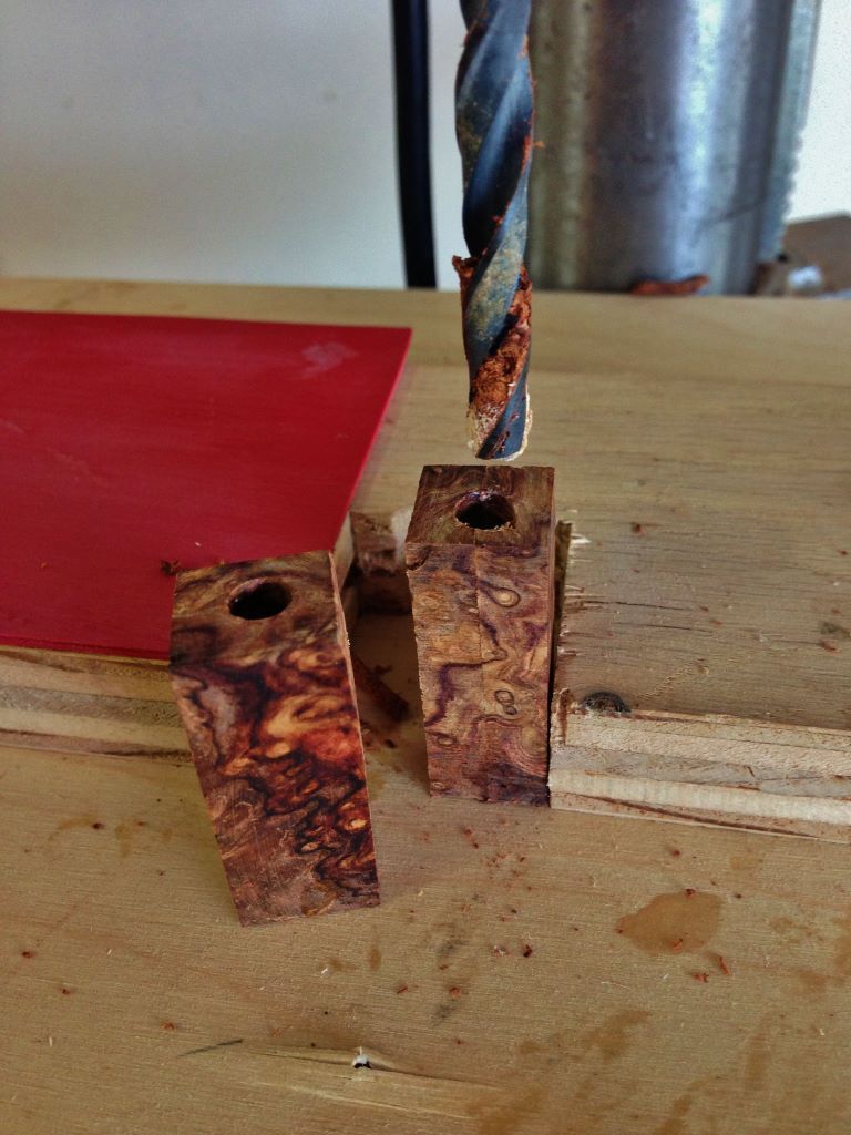

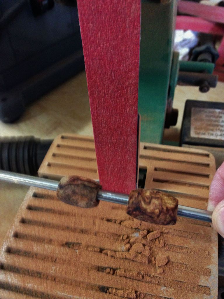

I don't have a lathe so I had to improvise with a drill press and small grinder:
They turned out great, that's what I like about wood working, there's always more than one way to skin the cat. With how symmetrical they look in the original pics I would have put money on them being done on a lathe!
