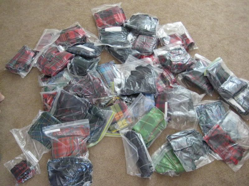

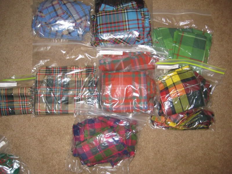

Well as my screen name would suggest My family is originally from Scotland and believe it or not I made kilts for around 6 years for a living. I have tubs and tubs of scrap remnants that I have Neve found a use for until now. Has anyone ever done micarta from wool. And if so what were the results? I have seen one set of scales but never heard how they held up. And help would be great. About to try a few goes at it in the next week. Here is a bit of the wool i have. More bins packed away...
I am thinking about using the bottom left brown arizona state tartan for my spyderco bushcraft.

Like i said i can probably make enough scales for 50 plus knives if i wanted due to the ridiculous amount on fabric i have left in rubbermaid bins. If the first one turns out good these may end up posted for sale. Most people wouldn't use this fabric because it is far from cheap. $60-90 per yard is a big kick in the balls for someone just wanting to make knife scales.
The only problem I would expect is the lanolin in the wool keeping the epoxy from wetting out. You might need to do some kind of degreasing step. It's worth a shot though if you've got scrap fabric.

Yeah, I'd agree that might be an issue. Depends on how processed the wool is.
Try rinsing in Naphtha to remove the lanolin if you feel it is an issue.
I would make sure that your manufacturing process included a vacuum step after you have added the epoxy to the wool. This will help remove any air pockets and improve the wet-out of the fibers.
