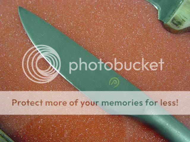

I sometimes wonder who he "hasn't" sued yet...I believe he made the threat of it ages ago on a forum I helped run but I just shrugged it off. Wootz IMO does look pretty darn good, I did want to do wootz fittings on a sword but the cost was a little prohibitive. I saved this pic at least 10 years ago now so cant remember who the smith is but know its wootz. Pic doesnt really show the pattern too well.
