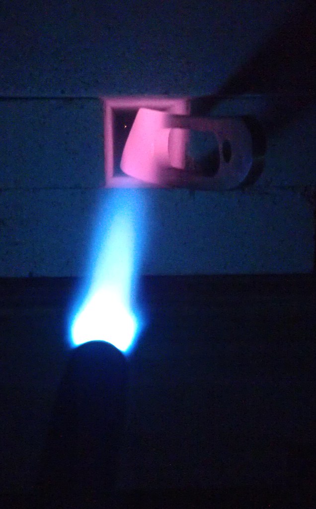

I'm working on my first kiridashi. The blade material is an old file I purchased in a lot of 20 files on ebay.

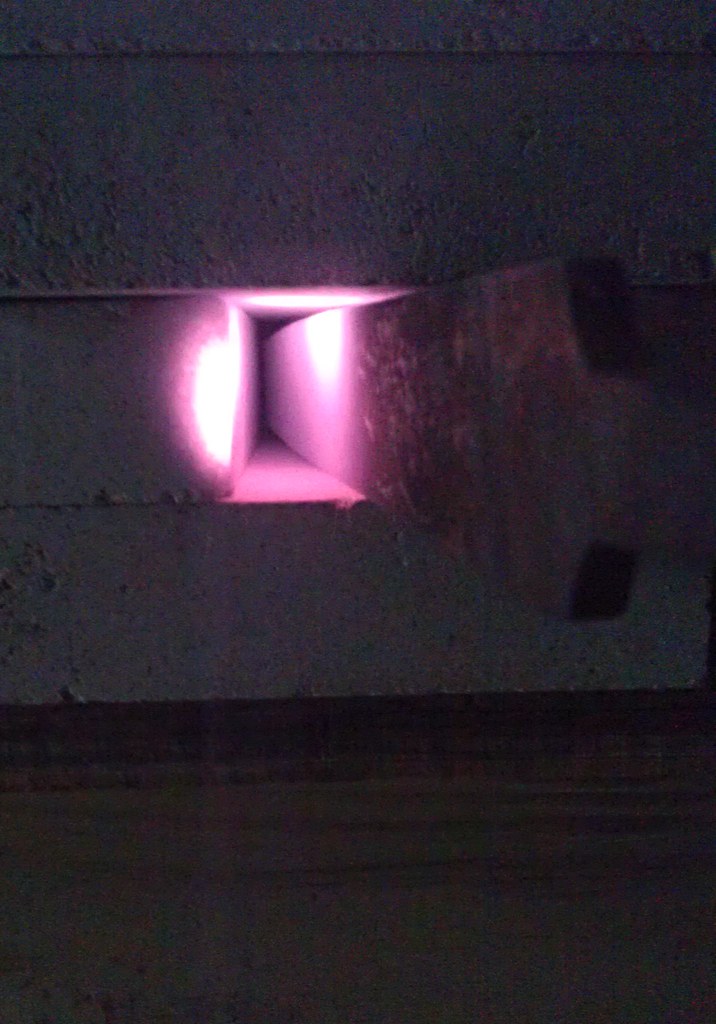

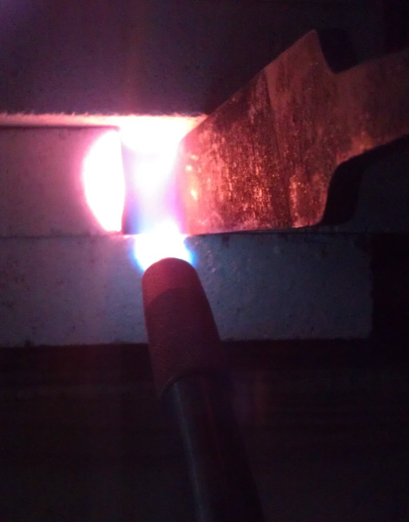

I got a gift of firebricks from a friend a while back (good friend), and this is the first chance I've had to put them to use in my shop. Prior to now, I've been using a Mapp gas Benzomatic torch for annealing and heat treating, which is far from optimal. Using the firebricks, I put together a very simple forge (in the spirit of Wayne Goddard's one brick wonder). Basically, I placed one brick flat, then used the sides of two bricks to form a chamber about 1", maybe 1 1/4" wide. Then I laid another brick on top to hold them in place and form a roof, and set another brick down flat behind, with a last standing on its side to direct the hot gas flowing through out to the sides and up.
Just using the Benzomatic, it got hot FAST.
Here's how it looked during my heat soaks before annealing:
With torch on
Looking into the forge
The blade removed for photo-op
In that last, I removed the blade quickly and snapped a photo, and then put it back in the forge. I'm really happy to be able to get a relatively large area heated to critical with just a benzomatic. I've already purchased hoses and a burner for a more permanent setup, but haven't picked up a propane tank yet.

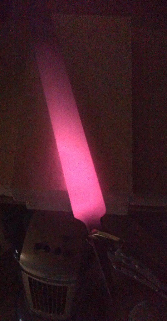

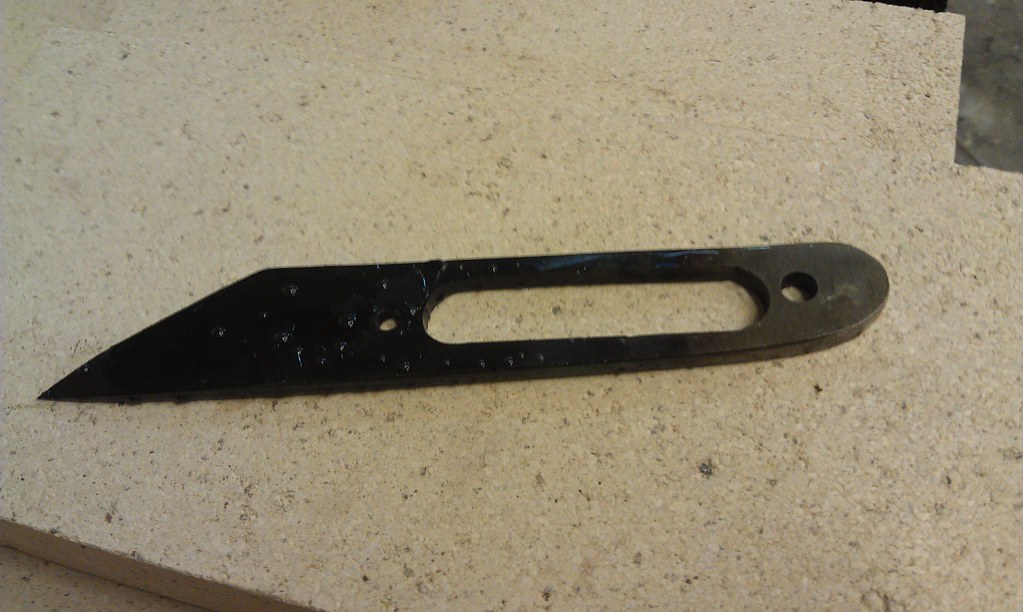

After annealing, I really got into the zone with cutting out and profiling the blade, drilling holes for the eventual cord wrap, and cutting out the inside of the handle, and I didn't even think to take pictures of the process. By the time I remembered, I was already in the heat soak for hardening (probably because I was reminded of taking the photos during the annealing process). Here's another photo of what it looked like:

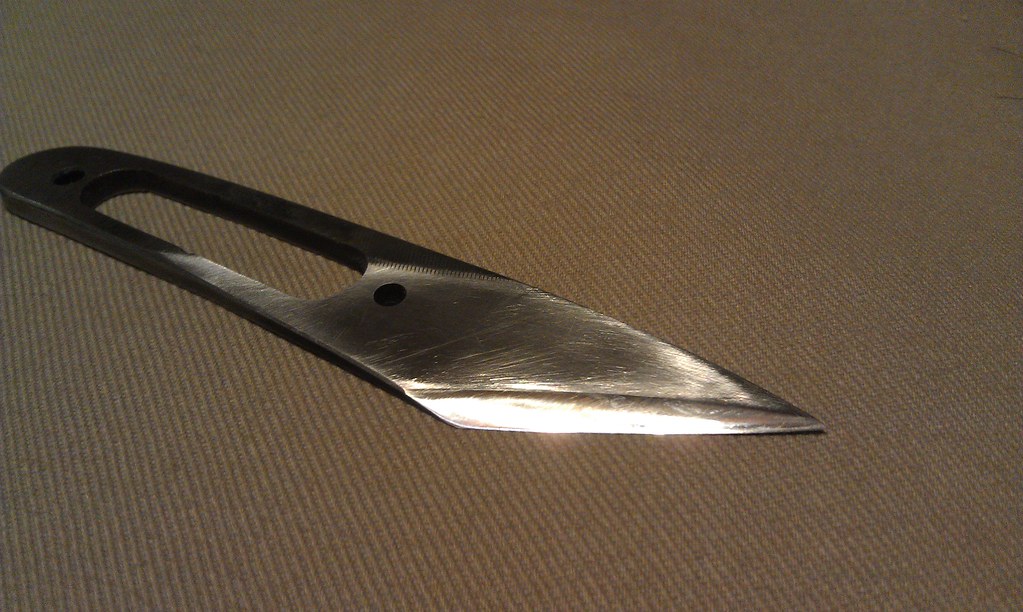

Right after quenching in oil, this is the blade profile
Sorry for neglecting to include anything for scale.

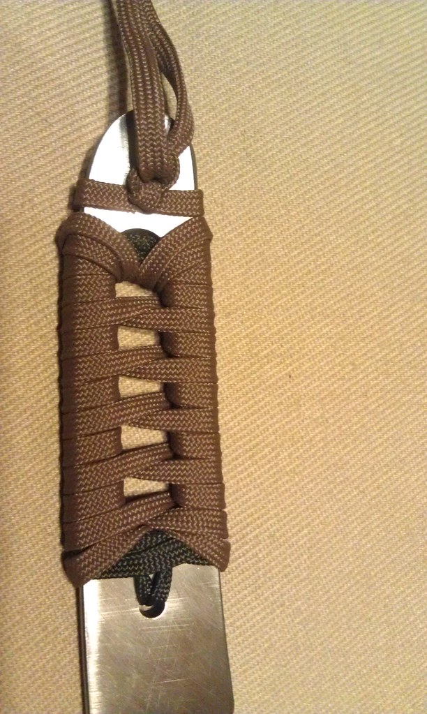

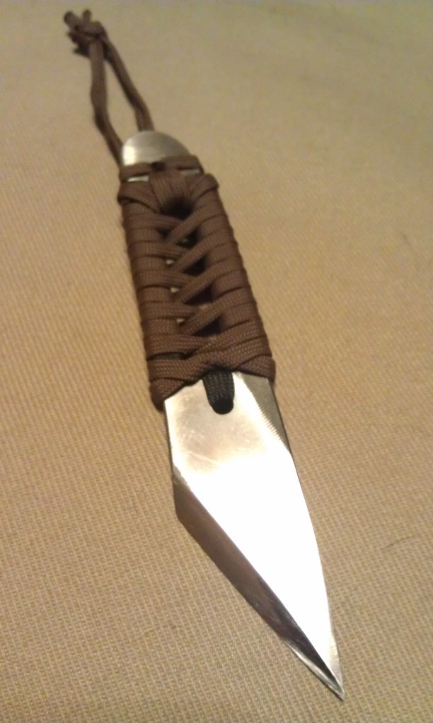

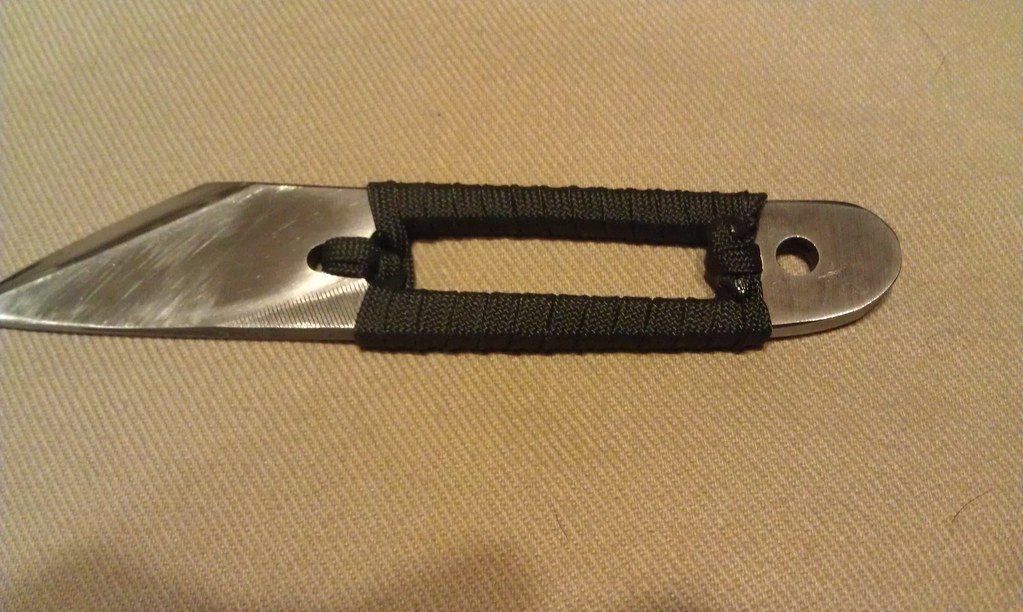

Right now, the blade is tempering in the stove. I'll post more photos after I've polished and sharpened the knife, and cord wrapped the handle.
