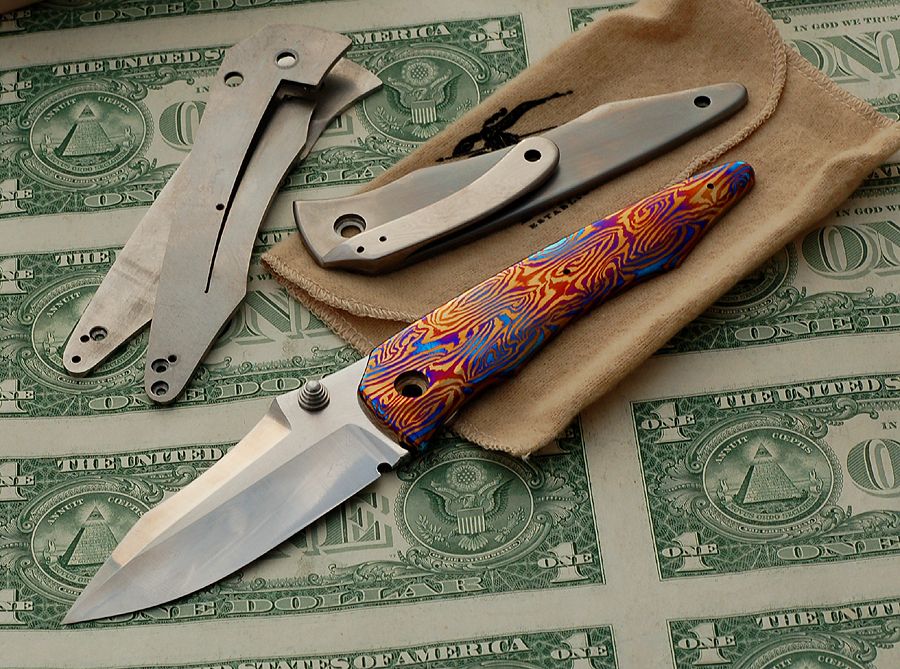

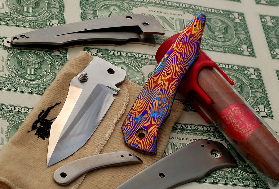

It's my pleasure. :) I do have a question, how is the clip atached? Just two pins or are there screw under the liner? Regardless it's looking great!
Best
-Kirby
Best
-Kirby
Thanks K.
The pocket clip is threaded and the screws come in through the Zirconium Scale.
The screw heads are countersunk into the Zirconium.
Thanks again for your interest in my work
Much Respect.

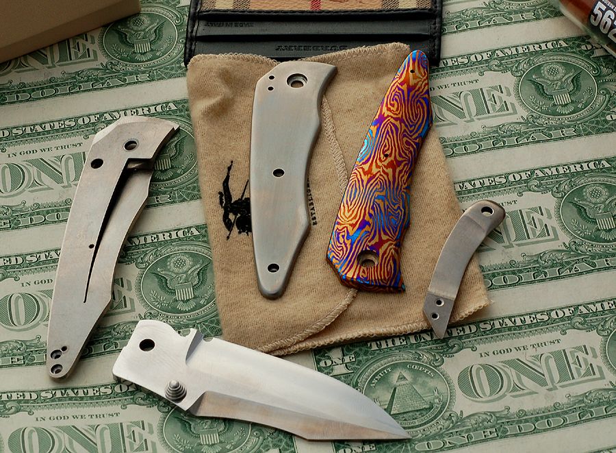

Another beauty there Mike. I love the way the pocket clip contours with the front of the scale and fits in with the overall profile. Awesome lockup and detent on that one too. I envy the guy who ends up with this piece.
Thanks Fam!
I really appreciate your post.
Here are some work in progress pictures.
Huge Respect from Texas.

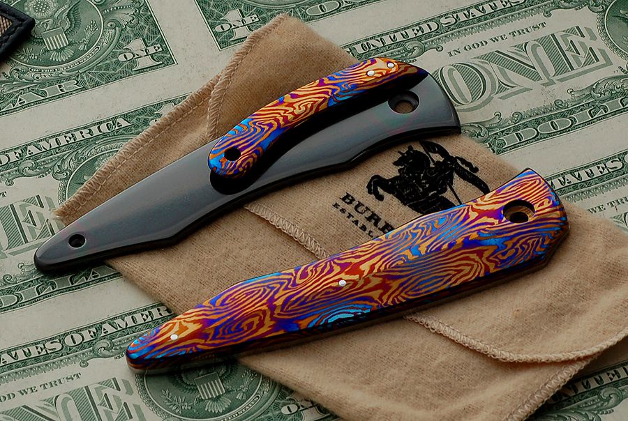

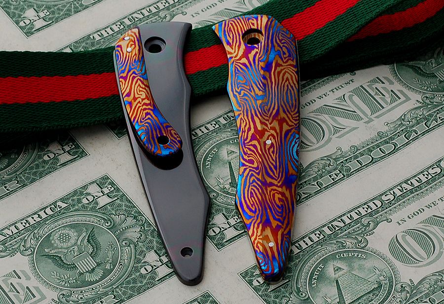

Thanks K.
I got the clip and the zirconium scale finished today.

That is SMOKIN' my friend....extraordinary materials and, with your outrageous skills, that's one of the most visually striking folders I've seen in quite sometime buddy. :cool:
That´s a gorgeous knife and easily identifiable as a Snody. Would you mind explaining why you choose zirconium for the back scale? I am not familiar with this metal and its properties.
Thanks
Brian
Thanks
Brian
Thanks Brian.
I chose Zirconium because it is cool and very dangerous.
Zirconium is becoming hugely popular on knives and jewelry.
It is a reactive metal which can be colored black.
AKS introduced it to our sector a few years ago.
It is extremely dangerous to work with.
May ignite spontaneously and burn with explosive violence. Ignitable by static electricity. Small amounts of moisture may promote the ignition of zirconium. Continues to burn despite immersion in water and does so with greater intensity than in air. Used to make corrosion-resistant alloys, in pyrotechnics, and for many other uses.
May ignite on contact with air or moist air. May burn rapidly with flare-burning effect. Some react vigorously or explosively on contact with water. The severity of the pyrophoric reaction depends a great deal on zirconium particle size, with the finely divided material reacting with the most vigor. The initiation of the explosion has been spark and by electrostatic ignition. Zirconium dusts have been known to explode
Some may decompose explosively when heated or involved in a fire. May re-ignite after fire is extinguished. Runoff may create fire or explosion hazard. Containers may explode when heated.
Fire will produce irritating, corrosive and/or toxic gases. Inhalation of decomposition products may cause severe injury or death. Contact with substance may cause severe burns to skin and eyes. Runoff from fire control may cause pollution
