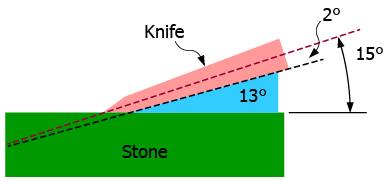

OP is correct that to calculate actual sharpening angle you need to sum up [blade primary grind angle] with [WS guide angle].
You can use Grind Angle Calculator to calculate blade primary grind angle. Just measure A, B and C on your knife with caliper.
Here is illustration how to calculate actual angle
