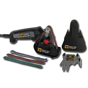

I spent two days with the Work Sharpener WSKTS for $70.00. Not that impressed. First problem is if you follow their instructions, you will round out your tip of your blade. The next problem is the 20deg guide doent work with knives with thumb studs or thumb discs.:eek:
I sharpened a few cheaper knives and the results were o.k but they were not shaving sharp at all. I then free styled for a few hours without any guides and the results were better but still average to poor. There is too much of a gap between their fine purple belts and medium red belt. I guess its a good tool for lawnmower blades. Thank goodness I am good with my Lansky system to fix a SOG Flash 2 that was butchered by the Work Sharp. The very thought of using the Work Sharp on one of my Emersons or Benchmades is crazy stupid. There is no free lunch here and a good Lansky Deluxe sharpening system is a much smarter and effective way to go.

Despite having the same issue with larger thumbstuds and the angle guide, I really like mine. YMMV, of course, but I've yet to have a knife come out of there not shaving sharp and ready to go.
Sure, if I took the time and spent the money on the right things I could get them sharper, but shaving sharp is just fine for anything I've let get past the touch-up stage.

I have found that mine works great for standard kitchen knives. I get mine hair shaving sharp using the guides. Very simple and super quick. You do have to be careful to remove the knife before coming completely off the belt to avoid hitting the tip hard.
I wouldnt use it with the guides for high dollar knives. I would probably use it w/o the guides freehand. For the price it is a good unit!

I ordered one last week.I have sharpened two pairs of scissors, a few folders, and a couple of kitchen knives. Here's a couple of things I noticed. The first folder I tried (Kabar Mule) didn't turn out very well. Parts of the edge were, well, sort of sharp. The tip was rounded off. It wasn't a very pretty picture. If your new to this machine (and sharpening on a belt sander like I am) start with the cheapo knives. I knew that fact going into it but excitement got the best of me.
The thing that changed everything for me was that the first time I used it, I had someone tape what I was doing (with my cellphone). I watched the video when I was done and realized that I wasn't paying attention to the angle as I drew the knife across the belt (probably explaining the random sharpness). I was dragging the tip off even though I thought was stopping and pulling the tip off. I also rushed the entire process.
Once I settled down and really focused on what I was doing, I received MUCH better results. Finishing on the highest grit belt (6000) leaves a great edge and for my purposes will do a fine job. It's not the most beautiful looking edge I have ever seen. It's definitely not a replacement for an edge pro or any other high end sharpening device. But for the price, and for someone who has had mixed results using other devices, it works out great.
Just a couple of last notes. I think the jump from the 220 to the 6000 is pretty big - I feel like the 6000 grit belt should leave a finer finish than what I get. Switching belts is a breeze. Being in an apartment, a larger belt sander isn't really an option. This unit works perfectly for me because the noise is pretty minimal. Probably not the safest idea to use indoors, but out on my deck, it works great.
