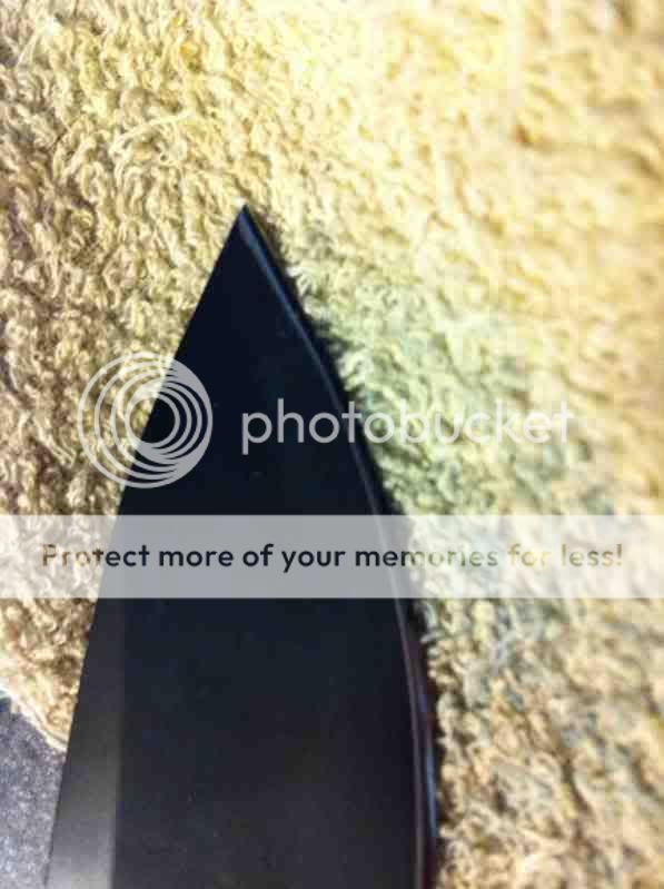

I don't believe it's 100% the same, as even going near the end of the belt without dragging it off will round the tip. It's a similar technique, as going completely off the stone are guided system can take off the tip. But not entirely the same, as the belt flexes while the other two are perfectly flat. As a rule of thumb, I drag the very tip to a little less than half the width of the belt before taking it off, thus I don't flex the belt. I also try to ease up on the pressure near the tip because it's thinner than the rest of the edge.
Another important thing is to keep the edge parallel to the belt as much as possible, and it becomes more important near the tip.
This is the "correct" position:
This will round your tip despite not dragging it off the belt:
This will seriously screw up the grind:
Not sure if you can tell, but I screwed up the grind on my American Lawman by running the knife through like in picture #3:
great pics. i agree here, as this is how i rounded my tips. i didnt run them off the belt, just a little too far on the belt like in pic #2. the other points you give are equally as important, as i then started doing what you show in pic #3 and ended up with a huge bevel near the tip, which is worse, since it cant really be fixed without removing alot of metal.
