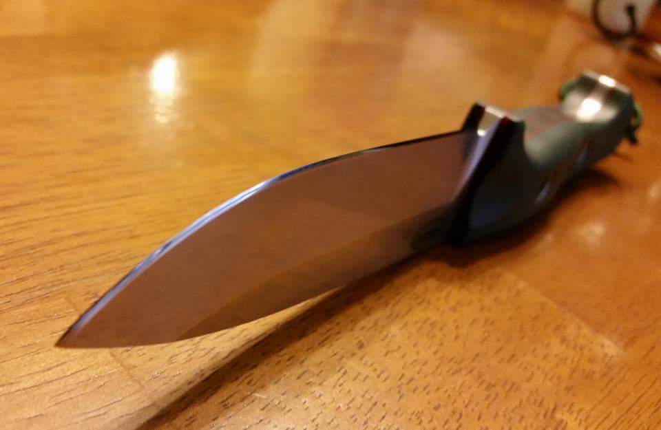

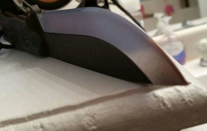

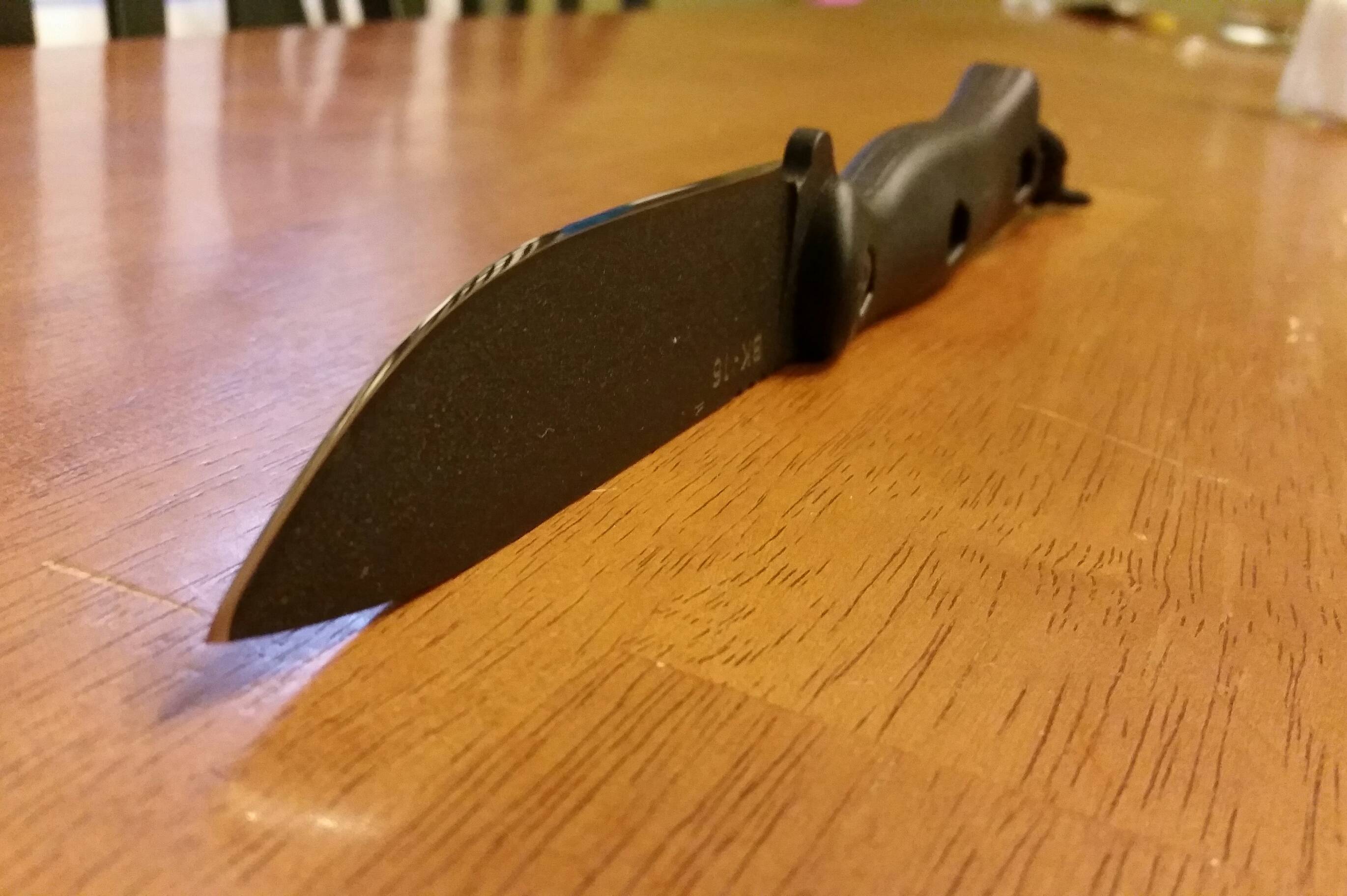

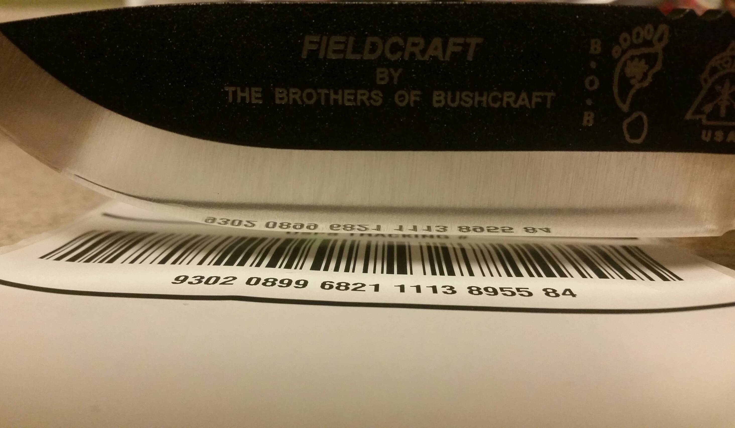

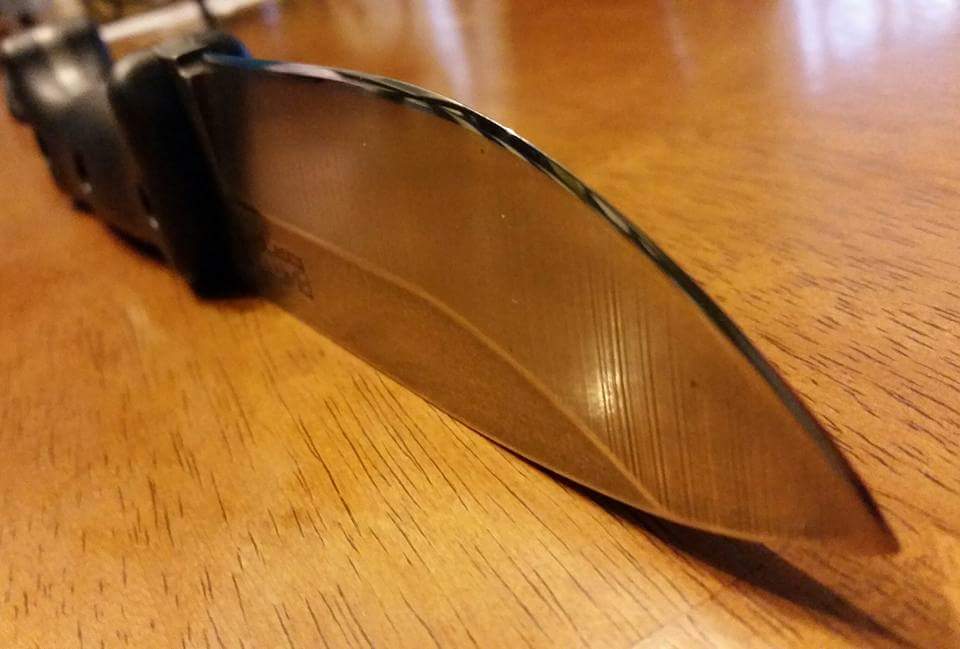

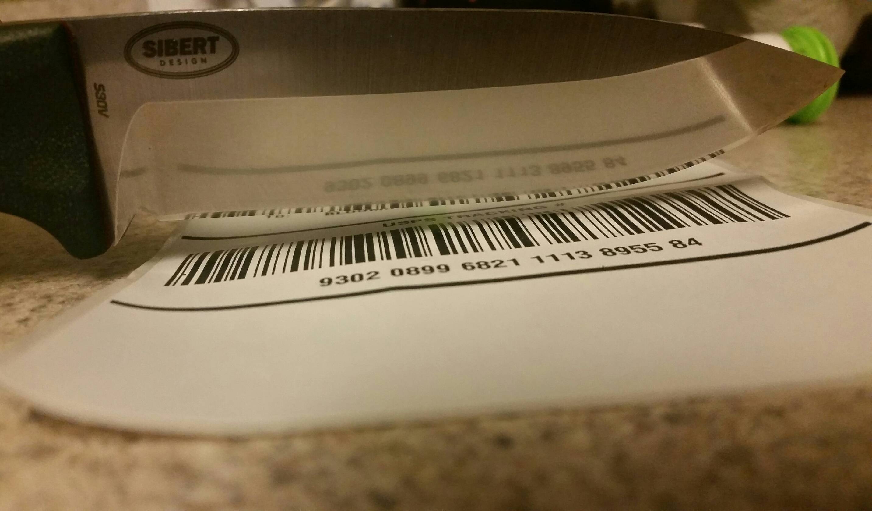

Ps. All those knives were done on the Ken onion work sharp with optional blade grinding attachment. The 12k stropping belt brings it to a slightly hazy mirror polish, then a strop and compound will bring it pretty close to a mirror finish. Eventually I'll get some optional belts to bring the grit progression closer which should yield near prefect polishes before stropping.
