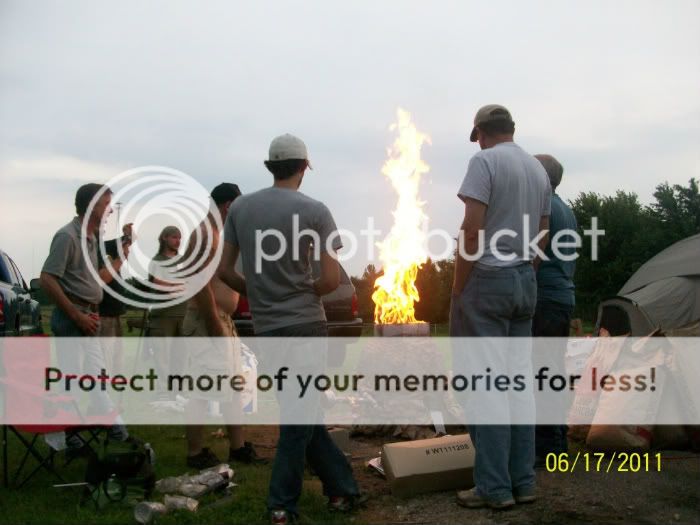

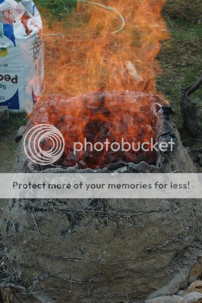

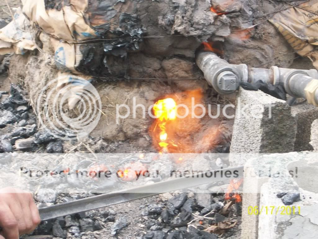

here are a few shots of us doing the smelt
so what was your ore, how much of it and how much charcoal?
How does that bloom spark??
Karl we fired this thing for almost 6 hours if i were going to demo this at the Ohio Classic Knife Show i wouldn't be able to sell any knives but maybe its something we could do at one of the hammer ins in Troy

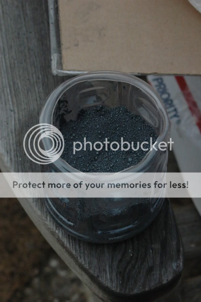

the ore is metallurgical iron its 68 % iron and the remainder is oxygen

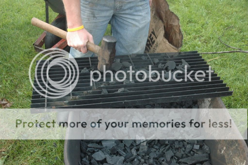

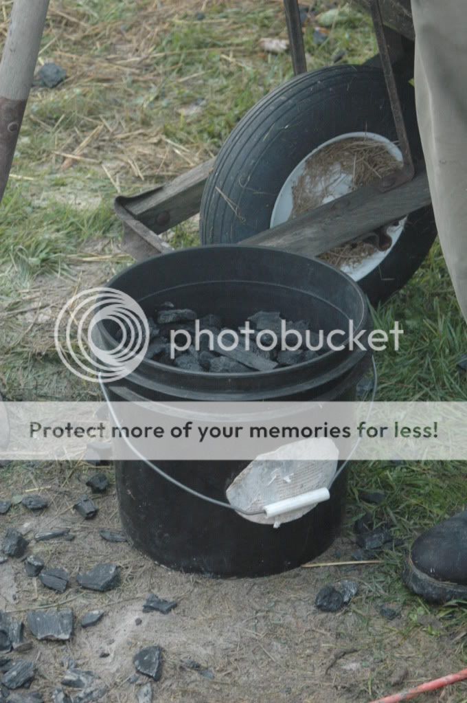

we were adding about 1.5 pounds of ore to a 3 gal bucket of charcoal every 7 min give or take...when the time increased it was time to tap a hole for slag
