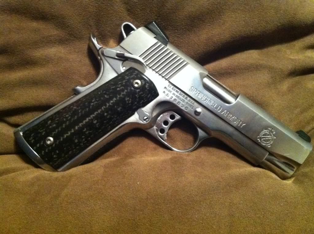

I made these for a Springfield champion I used to own. I shaped them on a belt sander, finish sanded to 2000 grit by hand, and polished/buffed with a cotton wheel on bench grinder and some jewelers rouge. I was extremely pleased with finished product. Defiantly wears longs leaves and paints, and respirator. I would even wait for a cool day or have a cooled room to work in so you don't sweat while working with it.
