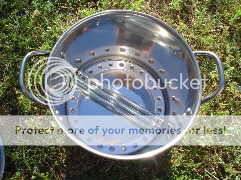

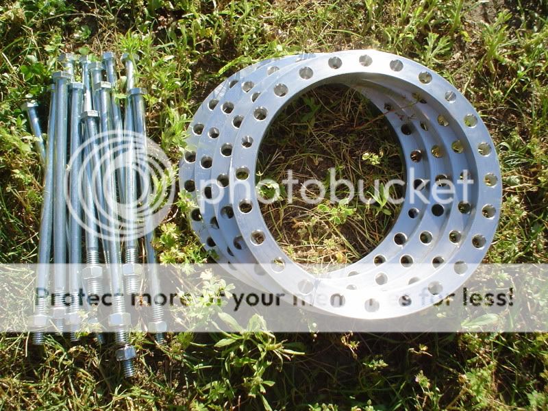

We made these pot stands a few years back to boil water in the winter with stoves. It takes way too long, so we use them to support the pot directly in a fire now. They last a few years (aluminum) before the heat degrades them and we have to make more.

The above picture shows how we use the pot stand. We find if you support the pot in the fire and keep the flame fueled from below you get a much faster boil than just balancing the pot on burning logs. 2.5 gallons is very doable and does water for everyone in one go.

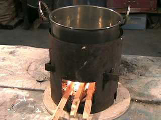

The simple version is a VITA stove ... cylinder with a grate and pot supports, the gap between stove and your pot is the most importnat "airflow" consideration (I imagine 14mm for your size pot )
The VITA stove http://www.youtube.com/v/UD2bIQlBgwU
http://www.aprovecho.org/lab/rad/rl/stove-design/category/1
Instructions for Building a VITA Stove

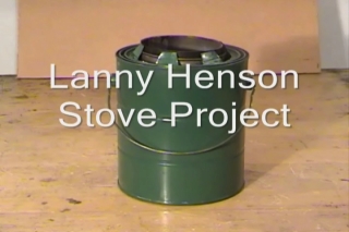

The fancy version would be a sunken-pot collapsible ... http://stoves.bioenergylists.org/henson2buckpopup ... this way you get extra "chimney" height for good draft, and you get full length coverage for the pot skirt (increased heat transfer)

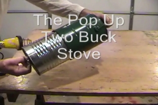

heard of the "caldera cone"? Same idea ... go to hardware store, buy a 3 gallon metal bucket ("pail"), add in some metal skewers for pot supports and you're practically there, just need to turn metal lid into a grate, and punch holes beneath that for primary air ... use the VITA stove instructions as guide
