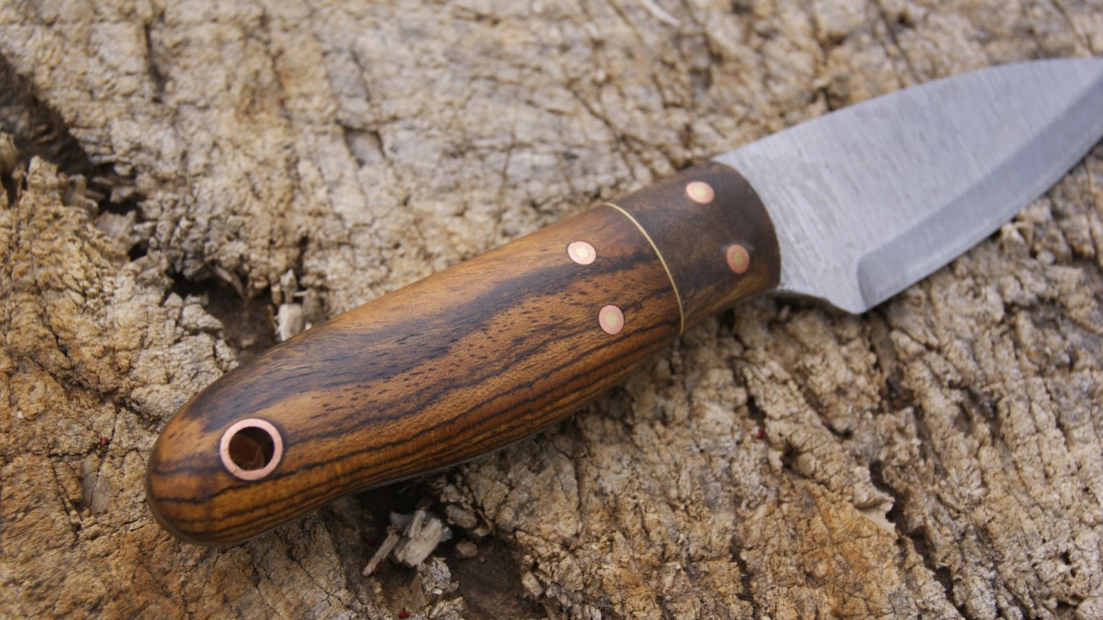

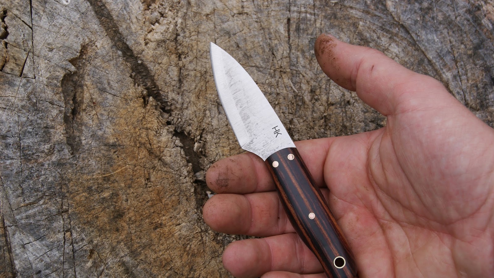

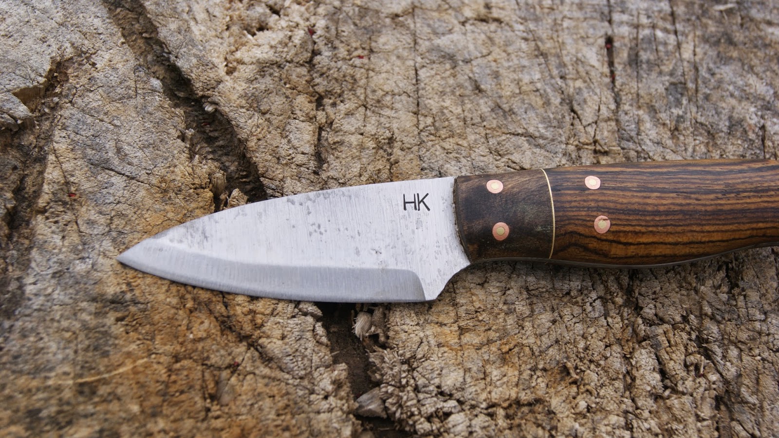

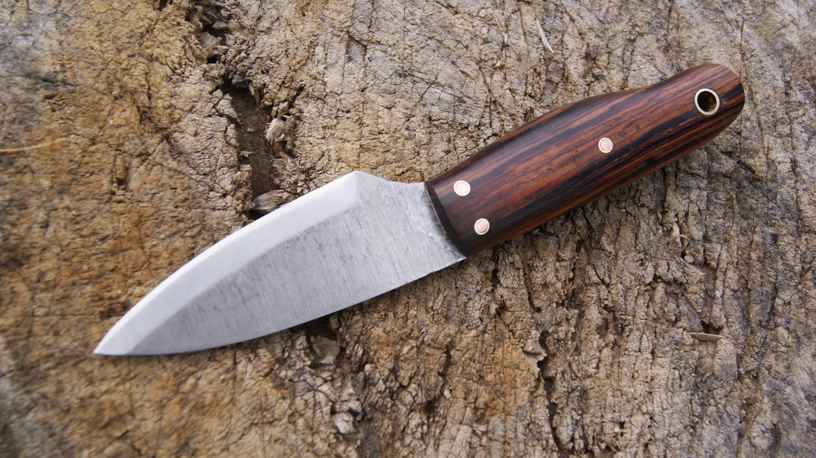

I asked john to add some extra pin holes this time around to i've me options, not set on the holes yet but these provided some interesting choices.
(I'm also experimenting with brass and copper core 1/8" pins, kind of interesting looking), anyway, take a look could ya?
this one's in stained spattered maple and bocote, still putting some finishing touches on it but here you go

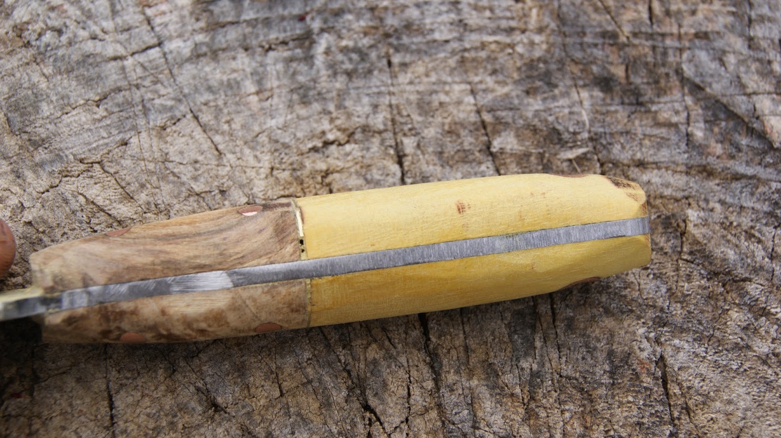

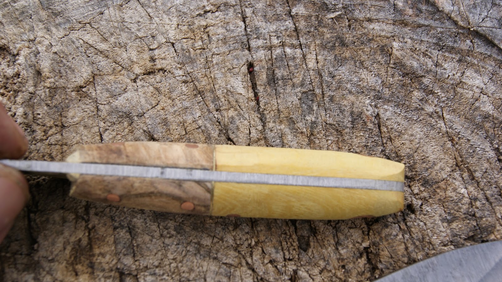

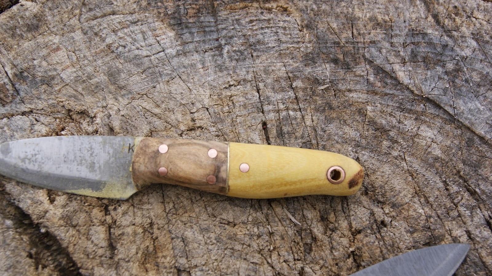

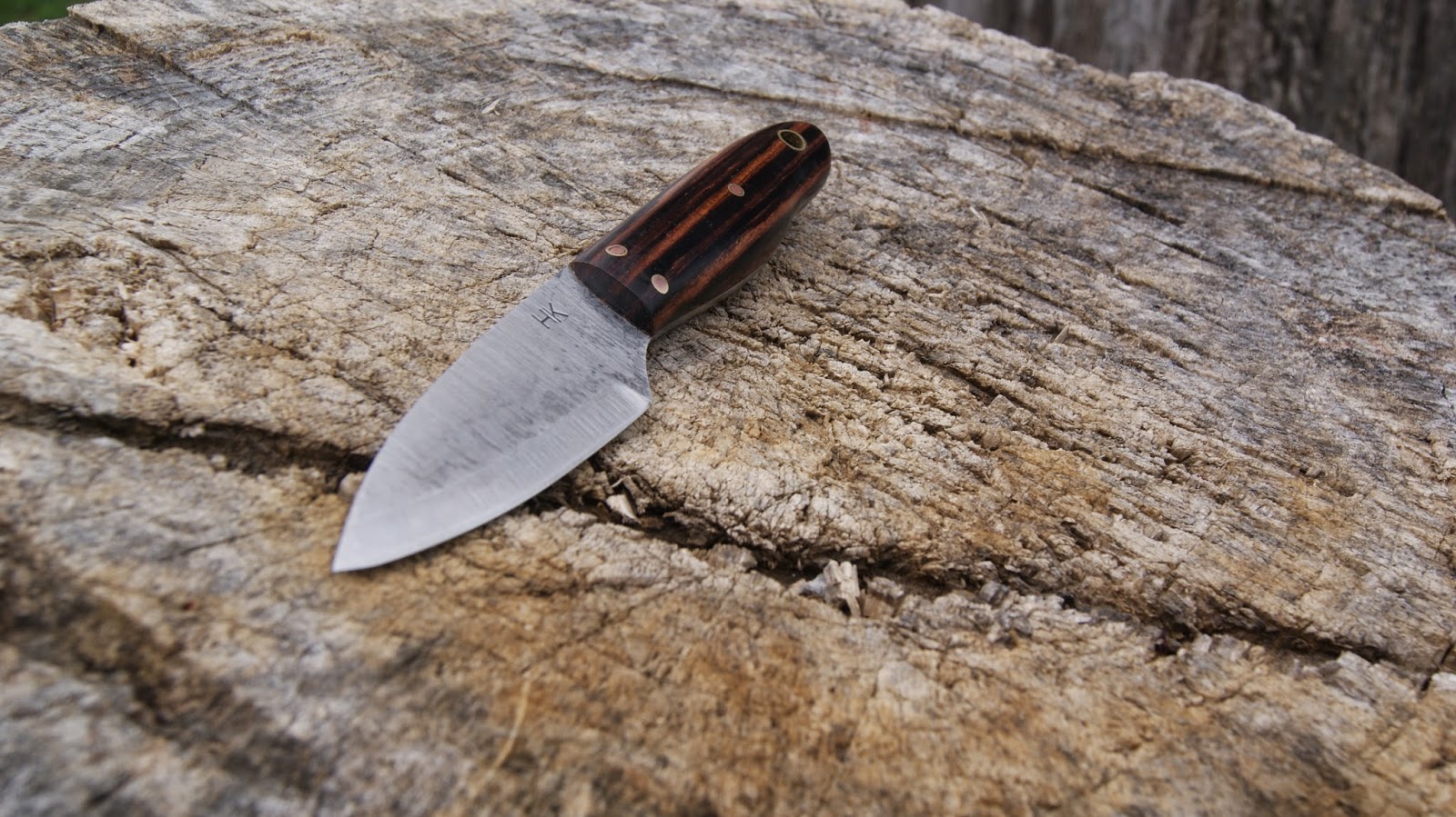

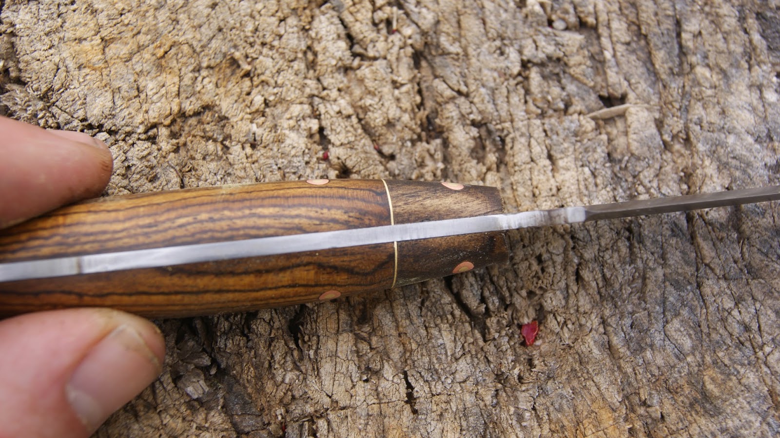

this one, well, it's a good example of why i didn't want to work on otehr peopls stuff just yet, i love the color combo on the scale material; (osage and unstained spattered maple) but messed up the divider as you'll see in the last picture, also, no, this one isn't as finished as the last one, figure i'll just have to start over on it so i stopped.
see it?
here's what it should look like

Those are supurb. I looked at each picture several times and the thought kept coming to me that "these are heirloom pieces". Beautiful!
Yes - those are a nice iteration. I admit that I prefer the 4 pins on the first one rather than the 5 pins on the 2nd. Maybe 6 pins will look more pleasing to my eye. I'm not really a guy who needs symmetry but in this scale, placement is important - easy to loose the balance of the piece. I do like the osage and maple combo.

Nice work, Peter. What do you think happened with the brass spacer? Inconsistency in the metal?

Cooper: it's really awkward to clamp them I image the expanding epoxy pushed it out a little...or I just didn't notice it was flush when I elf it to set.

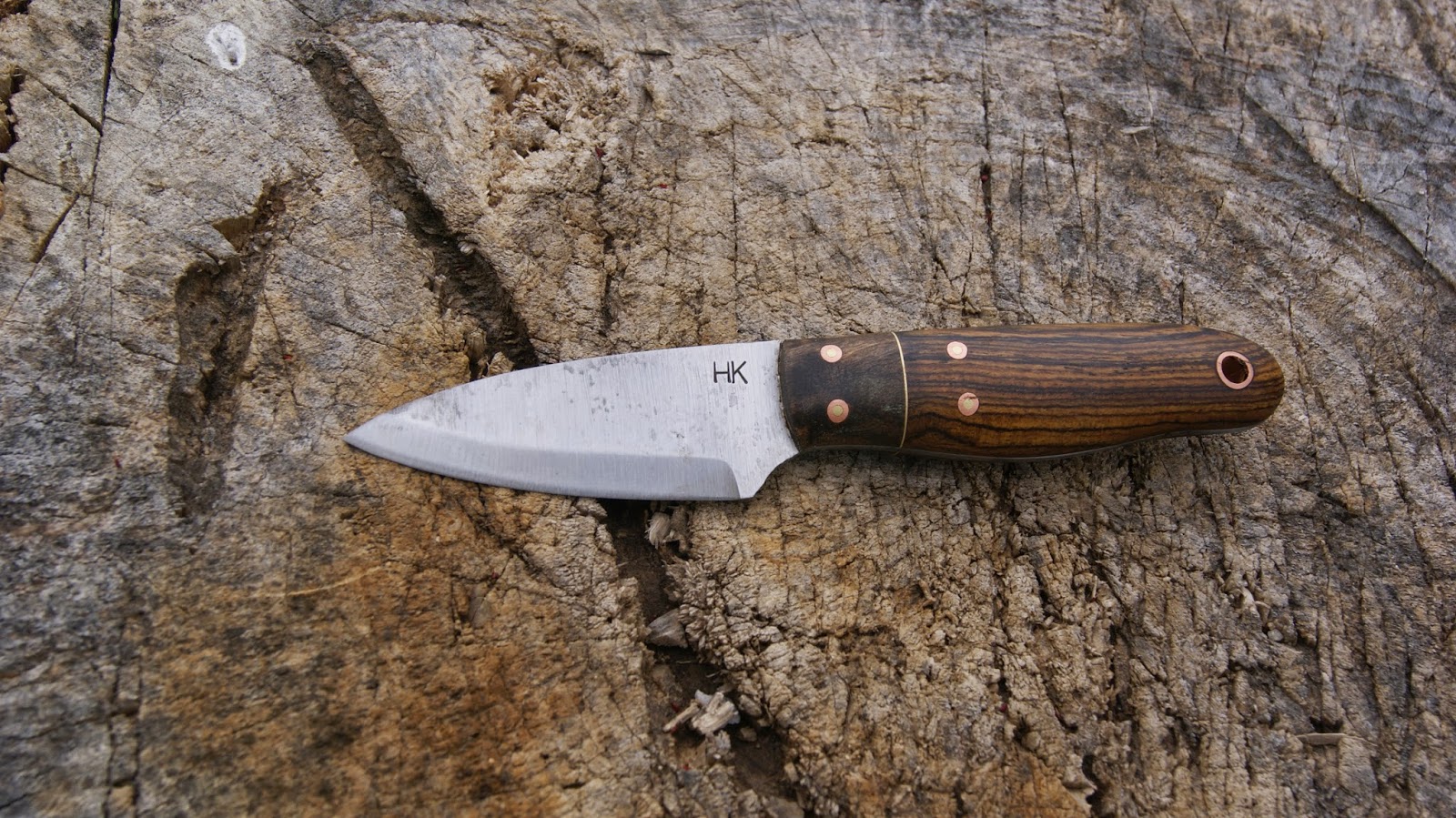

okay, last one before i start working on some other stuff (I'm expecting some liners and other material in today)
I'm trying out a new wood finish, it's a little more work to get it to settle in and finish out but I think it'll produce that nice luster on a wood handle and prove to be better protection in the long term without maintenance then linseed oil.
oh, and it's wearing cocobolo with copper core pins in a "3 star" set up
I think the 4 pinned version looks better (and so does the 3 pin), and although I'm partial to Brass, the Copper looks pretty nice. With copper I was wondering doesn't it tend to turn green after a while unless it's got a coating over it like laquer.?

thanks, mack, was wondering if i'd gone to far with the pins.
