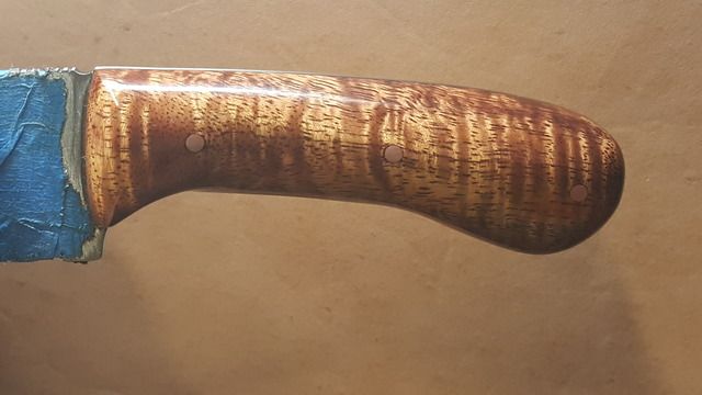

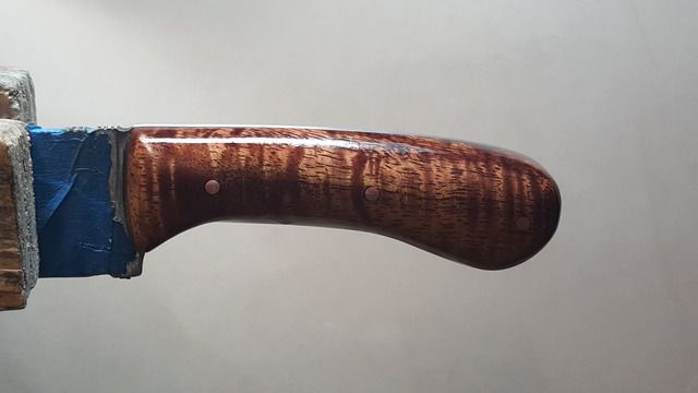

I wanted to share a few pictures of the KOA handle I'm working on. I sanded to 400grit and then wet sanded with Tru-Oil and 400 3 times. Then I did the same, wet sanding with Truil -Oil one time at each of the following grits 600, 800, 1000, 1200 and 1500. I applied an additional coat and let it dry, then hand buffed!
The pictures don't do this handle justice....It's got some serious chatoyance going on. Looks like a hologram at different angles! thanks for the help fellas!!!
