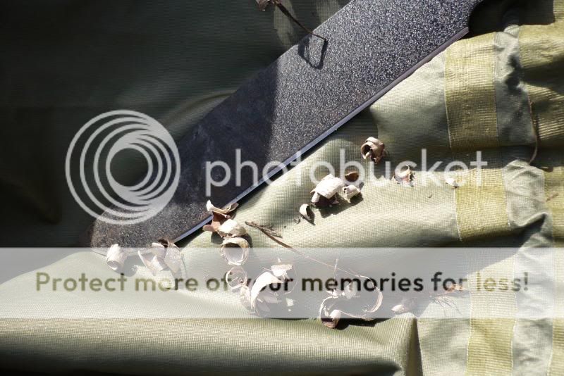

If you were after making fuzz sticks or curls of wood to act as kindling to get the fire to start you could certainly get them from the knife "as is" from the factory ....

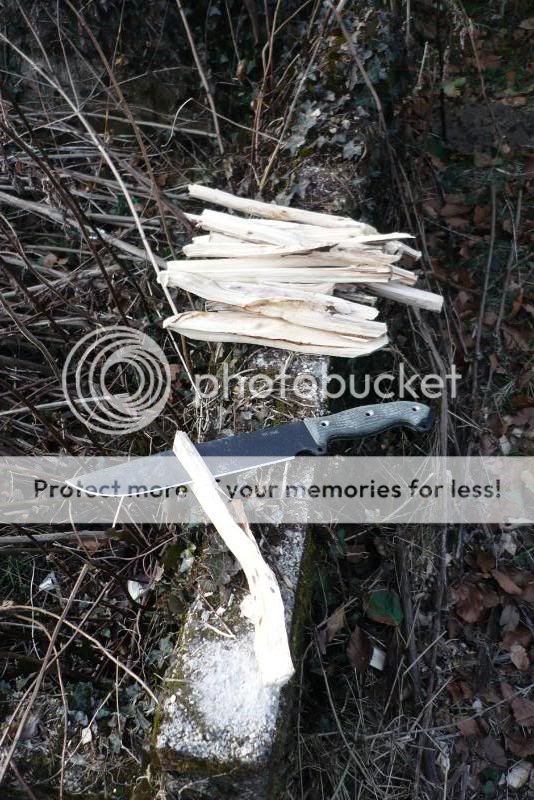

These will certainly get a fire going ... even if you were in need of using a ferro rod they will still "take" the spark to a flame if mixed in with some dry dead standing reeds or twigs .... but what this type of edge looses compared to a more acute sharper convex grind is the element of control on the cut ....

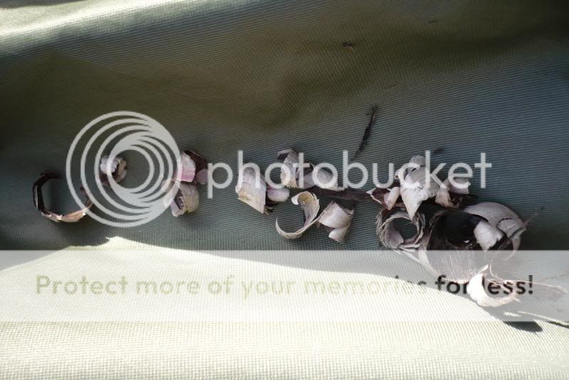

It will easily remove the wet bark from sticks as above but when you go to make a fuzz stick it is likely that you will get one or two curls going and then when going for the third the blade might hang up a little and need a bit of "umph" to keep the cut going and once done you find you have powered through at the base of the cut and lost all three curls to a full whittling cut and if they are on the wet floor the benefit of them being "dry" is lost. That's why when cutting fuzz sticks I do it with a jacket on the ground to catch those curls which go astray .... sometimes if wanting the job done quicker it is easier to just go for collecting the curls on the jacket from the start ....
