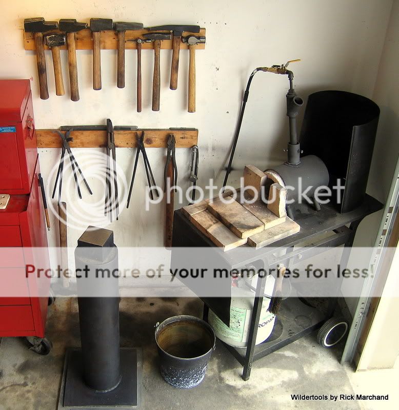

I put mine on a BBQ cart and use a split section of stovepipe as a baffle/shield. I don't like wall mounted flashing as you never know whats going on behind it. If I'm doing a long sword I can pull the cart out.
Hey Ric, won't that stove p[ipe baffle cause the heat to come up onto your gas lines? Just concerned for your safety. Frank
I think Rick has a good point there about seeing behind your heat shield. I like the idea of an obstacle to radiating heat, such as sheet metal over hardy board, with good air space between it and the wall.
Thanks Frank.... I can hold a bare arm over that area indefinately(or until my arm gets tired). It is hard to tell from that pic... but the black pipe extentions after the elbow are about 8 inches long. It is all very safe....... well as safe as 40lbs of LP being shot through a homemade burner can be, anyway.
Since I got my digital kiln... I've switched back to my little single burner forge. It is so much better for localizing heat where I need it.
Your forges sure look neat and tidy, but I just had to say that in case it was a brand new set up you had just started to use. Good stuff, Rick. Frank

Rick that's very true. I notice your forge has a large portion of the openings closed off, and I'm sure you have good reasons for this. I'm just curious in what way it benefits you?
I found that my forge runs well at 7-10psi with about 4 square inches of opening on the small single burner and 6-8" on the double at 7psi. It takes a while to fine tune it but after a few months of using it 3-4hrs a day, you get to know your forge. I can close the opening as I lower the gas pressure but only so much. Venturi forges are different than Blown units. Venturi are naturally aspirated and won't work properly if there is any back pressure working against the burner. If you close the opening you will inhibit the intake air from being drawn into the burner, but not the propane flow. This will result in raw gas filling the chamber and being forced out of the spaces around the doors and burner, where it will burn..... Not to mention, the large volume of unburned gas may explode.... which is bad, I hear.
