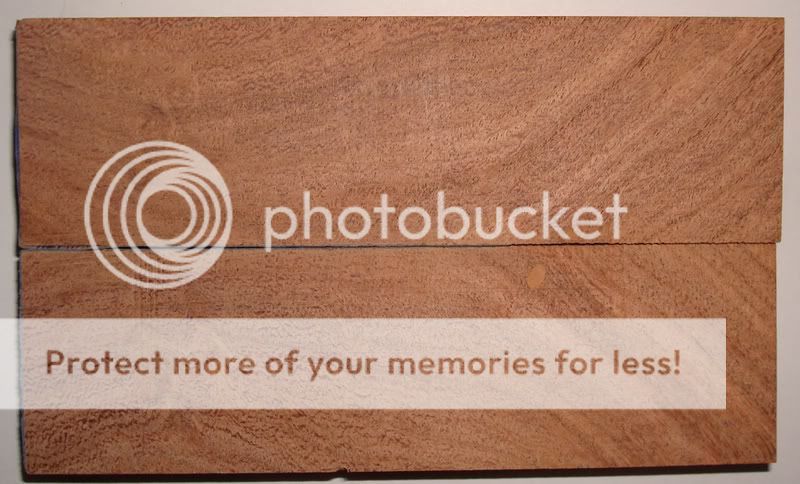

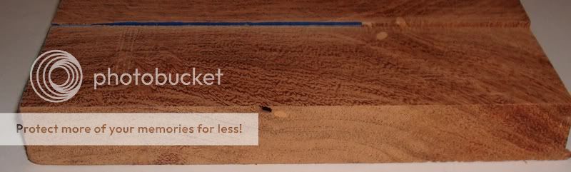

Do you guys tolerate any worm holes in your handle wood? I have a piece that I want to use on a low budget knife but I keep going back and forth. What do you think? S. Texas mesquite is notorious for this, BTW, and this guy likes wood with character. He loved the last slabs I used despite an obvious streak of black...a watermark for lack of a better term, almost a spault line but that would be generous.
Anyway, use it or send it to the firewood pile?
I know a knifemaker that used superglue to fill voids and pores in wood. He kept coating it over and over then sanded and buffed.
I haven't used it, thats what he told me.
Use the old cabinet maker's trick - mix glue and sanding dust from that wood and fill hole .

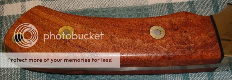

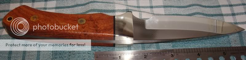

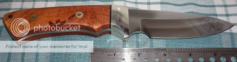

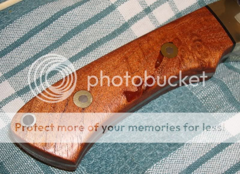

Using very fine sawdust from the same block and superglue I was able to fill the holes uncovered during the shaping process. It was worse than I had hoped, but only one one side. I suspect the end user will do more display than usage anyway, but hey, it is his now!
South Texas mesquite, hand rubbed (many times!) Danish oil finish
Blade is a blank from TKS, their "Hunters Delight", with moderate modification by me, mostly reducing the size of the grip area by a good 1/8" in total and flattening the sides to reduce the rounding from their (excessive) buffing job.
