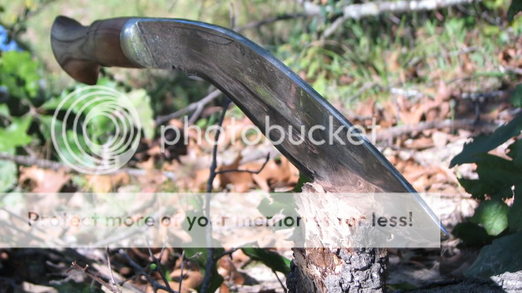

Okay I will play. Here is a tourist Kukri that I got off ebay from a bad seller who gave wrong information on his auction.
First thing I will have to mention is the sheer softness of the metal? Now I hear you saying "well how soft is it?" Well the other day when I was playing around with it out of boredom and testing I noticed a whole new gouge out of the steel near the fuller. Well gouges can sometimes happen as you know, but typically I am concerned when the blade does this...
Yes that is a gouge almost as deep as the fuller after there. Wasn't there before I started chopping on all of one sapling. The blade damage where it chipped and rolled is equally from the one sapling. This is after it was very well sharpened and nice and sharp. To go through an inch of wood would take about a dozen strokes even then and the main reason it cut was the weight. Other Kukris I played with can go through that in one swipe.
I did use it once before mind you to delimb two whole saplings as a test. The blade was chipped to pieces and rolled in sections. When I went to fix the blade up with a sharpening rod it ground through the metal like no tomorrow. I was taking out chips after a dozen or so movements. I had reground and sharpen the blade to as sharp as it would go, which is not that sharp. I estimate the hardness of the steel at perhaps RC40. I literally seen Pakistani cheaper blades made of the same stuff, and I imagine they come from the same steel supplies.
The blade also has major rust problems, especially on the pommel and in the blade itself. It been in a low humidity environment and fairly well looked after. No other blade has picked up a speck of dust, including the carbon steel blades such but this one went really bad. The pommel itself has massive gouges out of the end which is how it came and they rusted out even worse to leave big indentations. It really makes it pretty when a few wood saplings can ding, scratch and and do in the whole blade.
Here is a picture of the handle. Typically hardwood handle. Not badly done after I sanded down all the sharp spikey bits on the sides. Of course you can't do much about the metal there at the ring that digs out of the wood by about 3 mm and digs into your hand so if you don't wear gloves it creates a very nice blister where it rubs.
I try and take some more pictures in tomorrow to give a nice close up on the blade chipping. It really is a thing of beauty... well horror. Easy mistake.
