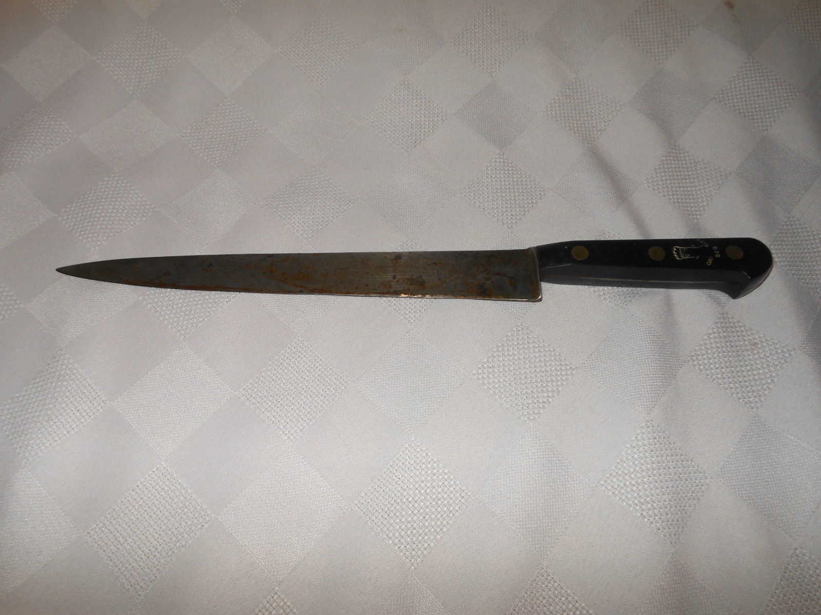

So I'm a cook who's interested in buying an old vintage Sabatier knife, and I found one for sale for a decent enough price.
However, the blade has quite a few instances of rust. Would it be worth it to buy and attempt to restore or is it likely that its too damaged/prone to breakage on use? I'm not a pro when it comes to fixing these things beyond a sabitori or some BKF so that's about the extent of what I can do for it.
Picture of knife in question

It looks functional. I salvaged a few old knives and machetes I found at my great-grandfather's house. There probably will be some permanent stains on the blade, but it should function just fine.
Here's your picture so that people can see it on the thread:
Go for it. It should clean up nicely! I do stuff like that all the time. Rusty old knives have soul.

That one isn't that bad compared to what I was expecting. You could probably clean most of it up quite easily with some Dawn and a metal scrub pad.
Pass on steel wool or any other metal based scrubber. I use Sctoch Brite cleaning pads. Hardware stores sell them that are rougher than household cleaning pads. get a rough one and a finer one to finish with. Put an edge and you should be able to get a few years of service.

So some BKF and scotch brite pads would be enough to restore it to decent condition yeah? Should I worry about rust inside the handle at all? Like I said I'm a little bit worried about the blade snapping when I'm trying to cut something because of it.
Whoaaa, thanks for all the input guys! I think I'll go for it.
You could always check for rust under the handle, but if it is riveted on that means new rivets or some kind of new hardware to put it back on if you remove it. I wouldn't worry about it personally. And don't worry - it's not gonna just snap from use. I'd just clean it up a little and use it. Use and a little oil will keep it from rusting further.
The sabatiers I've seen have relatively thick blades, so plenty of spare steel to work with. That knife doesn't look too bad.
Steel wool & scotch brite will clean the rust off. If you want to smooth the surface, lay the blade on a stiff backing, like a small wood plank, & use wet & dry paper, or even a sharpening stone, flat on the blade surface. Will come up nicely.
