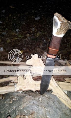

Howdy folks. As my knife-making dreams are on hold due to a non-finished garage, I have taken to messing with the stock at hand. This time the makeover was done to an M-Tech 151. Now, I know it is an inexpensive clone of a CS Trailmaster, but after seeing the destruction vids and favorable reviews I decided that it was good buy for the price. It would also allow me to practice my re-handling skills if I decide to do something to my trailmaster.

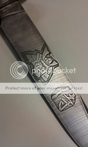

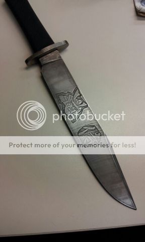

First thing to go was the coat. Surprisingly, it has quite even grinding on both faces and a clearly defined clip. after some sanding I tried a tweak on the acid etch process I'm still learning. Since it is made in China, I decided on an oriental theme. On the right side it got a kabuto (japanese helmet) and the kanji symbol for "samurai". (I thought I could not blue stainless, but a mix of gun blue and ferric chloride worked pretty good)

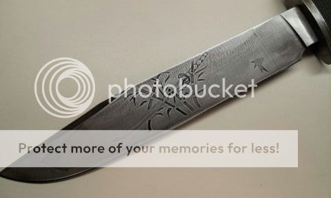

The left side was done with a homemade etcher that I made several years ago when I found this site and the instructions to a do-it-yourself etch process. Salt, vinegar, q-tips, gator clips and an old cell phone charger. 2-step etch with bamboo canes and a ghost katana

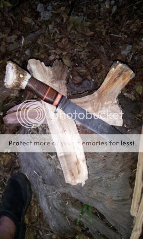

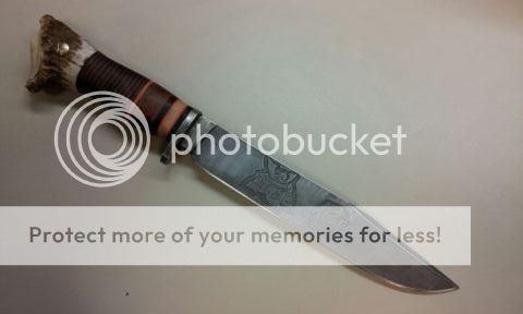

So, the blade got better looking...now it needs a better handle. I have done several leather stacks using other materials too, but for this one I wanted to try a full Scagel-style. You, my friends, be the judges. Top of the guard was loped off too.

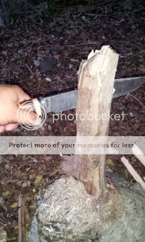

It has black g-10, pieces of safety cone/ safety drum, brazilian cherry, leather and topped with a stag crown. To celebrate it's good looks, I took it outside and beat it quite good while hacking off a heavy branch in the backyard that was too close to the power line, then chopped into sections and battonned into quarters left to dry. It also battonned a piece of dry wood that had been sitting for at least 3 months and included a couple of knots. It came out on top with hardly a ding on the edge, as I intend to use it as it was meant to.
Hope u likey. Next step is leather pants :D
well that was the easiest part actually. I used my homemade etcher and masking tape, drew the design on top of it then cut away with a hobby knife. It's basically a stencil that got acid and electricity applied to it.
That sounds interesting, like electrolysis or something. Does the electrical source need to be DC?
Also, forgot to add, the etchings look great :D
thanks. not sure about the source, I just use an old cell phone charger with the connector cut off and the wires attached to gator clips.
You have a lot of patience to cut that with an exacto knife. I'm going to have to try it now. What did you use for and etchant?

Thanks for the info! I have some PBC etchant. I took closer look at the pics of your etch. I admire your artistic abilities.
Ric
Thanks, I did a more detailed etching using a different method, painted the whole blade with the resistant ink and scratched out the design, will post a new thread later.
