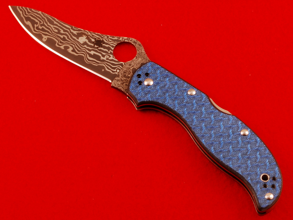

Yes, it's clad, but it's a VG-10 core clad with true folded damascus. Most Japanese damascus is done that way, with either a VG-10 or ZDP-189 core, and the VG-10 core is the most common. The advantage is that you're getting the edge holding of VG-10 combined with the look of a damascus blade. The disadvantage, is that the damascus pattern is limited to the area above the exposed VG-10 core.

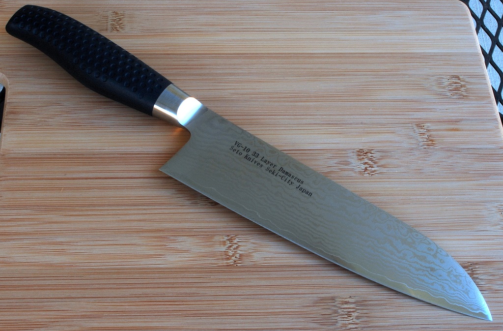

Personally, I wish Spyderco could ask both Moki and G Sakai to tone down the etch they use on their damascus, it's way too contrasty for my tastes. I'd far prefer omething subtle, like the etch on the Seto damascus kitchen knives they sell. However, I'm only one customer, so I don't expect it to happen.
This:
Instead of this:

See i am the other way. I love the contrast on my stretch. :)
I'm sure you're not the only one. In fact, I'd bet more would agree with you than with me.
I love how the Stretch looks, but I can see where a more "toned down", less contrast look could be very appealing on certain models.
