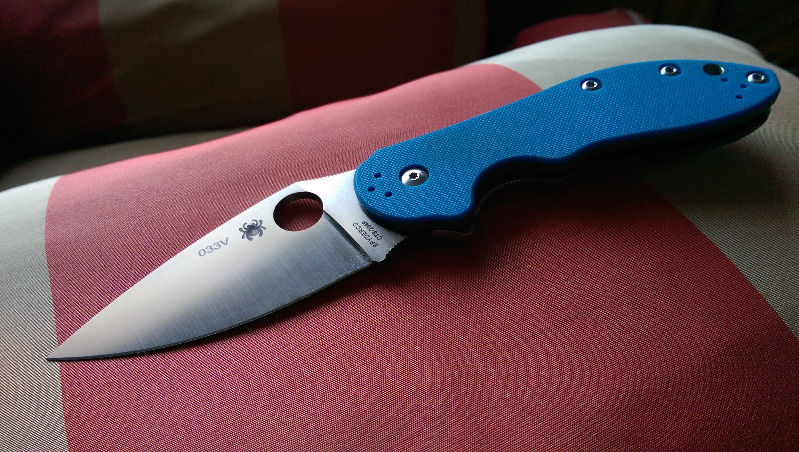

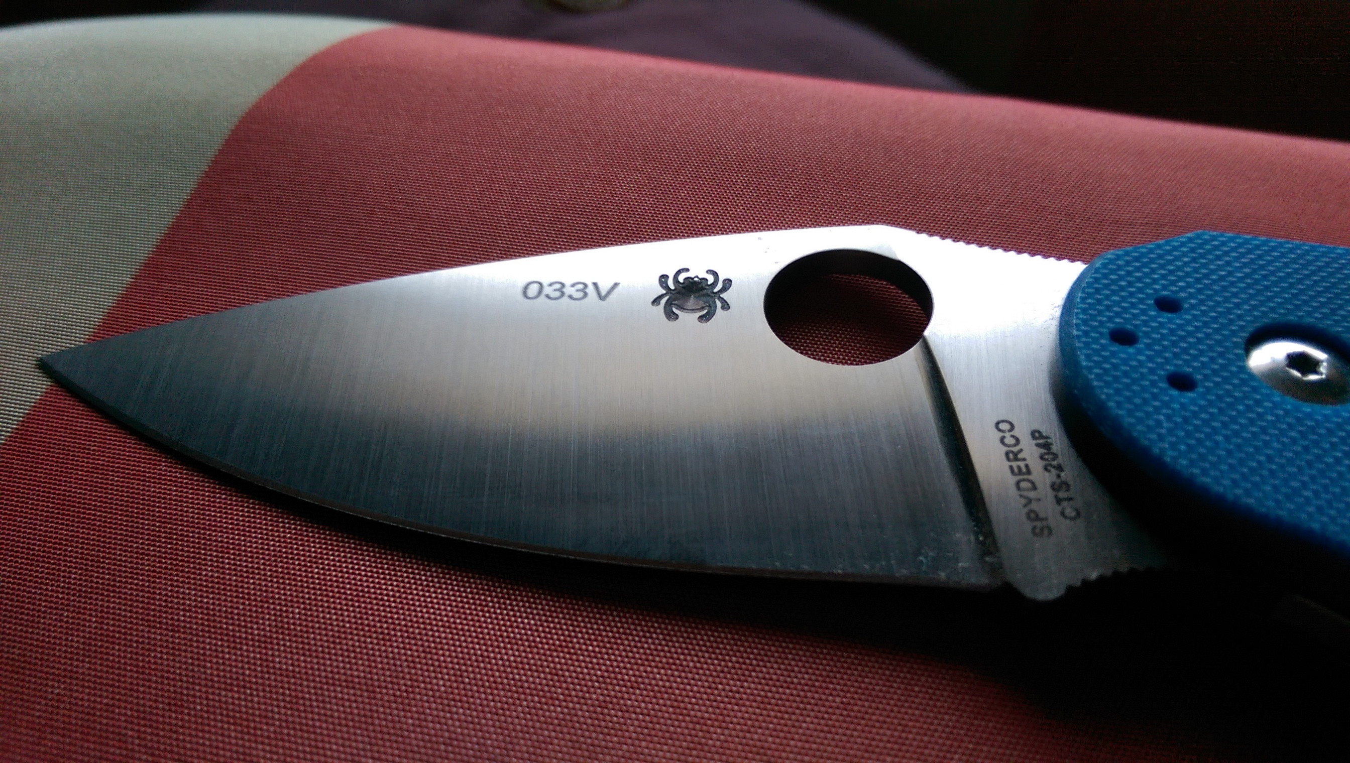

I ended up impulse buying a blue G10 Domino in CTS-204p that I saw at a local store yesterday and it's just about perfect, except for one little problem. I see the slightest bit of side to side blade play...I know disassembly is a no-go, but will I have any warranty issues if I try adjusting the pivot myself? Am I better off just sending it in to Spyderco to have the blade play fixed or should I just go for it and try to fix it myself first?
The knife is perfect in every other way: it fires out faster than any flipper I've ever handled before, super smooth action, perfect detent, perfectly centered blade, hair-whittling sharp (the sharpest factory blade I've ever personally received), and just about perfect fit and finish...I just need to dial-out this blade play and part of me feels a little silly sending the knife in for a warranty claim over a little bit of play, so I figured I'd see what you guys think...

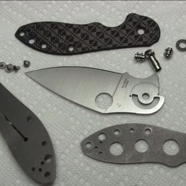

Yeah man, just go ahead and tighten it with the proper size torx bit. My CTS-204P Domini had a little okay as well, but the internals are the same as every single domino I've had. Just tighten enough to where you don't feel any blade play, and with a little luck, it'll stay centered. The gritty feeling is from the detent ball riding on the coarser finish of the blade. It will wear in to glassy smooth.
And Deacon, ive taken apart my Domino, and it didn't have a stepped pivot. Its like a three piece pivot. One female pin with two screws on either side. If I take out a screw I can push it out of the other side.
Interesting. I based my statement on a photo of a Domino disassembled that someone posted a while back, and the pivot (or at least what I assume to be the pivot) looks stepped to me.
Thanks for encouraging me to do it myself guys...I realize it would have been silly to send my knife all the way to Spyderco to have them do just a simple adjustment. I ended up tightening the pivot with a T7 torx driver and it's perfect now. Still flips out super fast and now locks up dead solid. I love this little Domino!

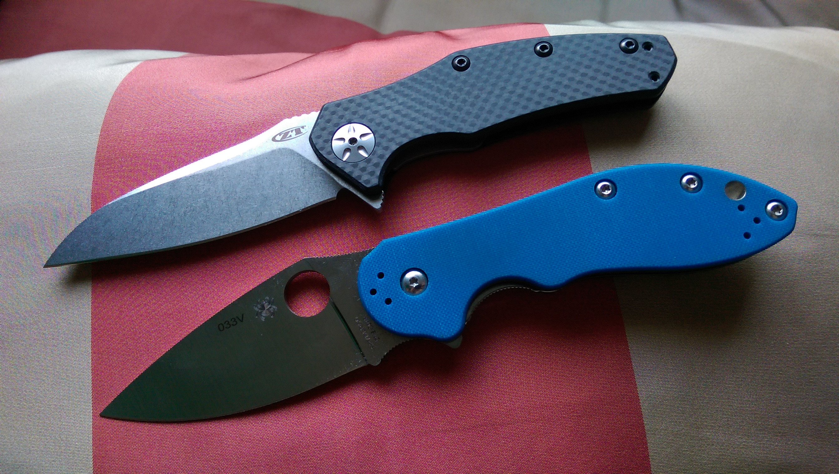

My Domino with this week's other acquisition...
