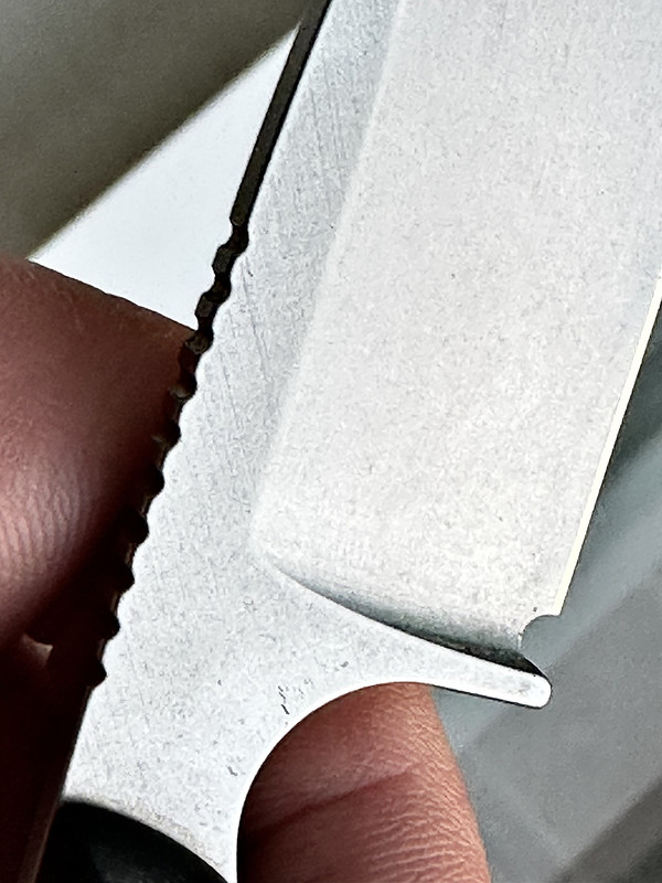

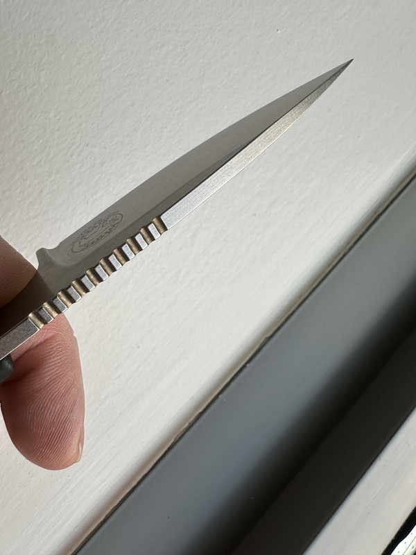

I always thought that one for the defining characteristics of White River products was their high level of fit and finish. The two other White River knives that I own are pretty much flawless. However, I'm not too impressed with the finish on my new M1 in magnacut. As you can see from the pics below, there are visible diagonal grind marks as well as some pitting on the flat part of the blade. In addition, there is orange discolouration on the jimping (kind of hard to capture in a photo) caused by excessive heat.

Can you draw a line, or circle the marks I can't tell what you are referring to?
All I see is roll marks from the raw steel.
Not sure what flaws you see?

The golden color jimping is from heat treatment tempering?
350-400Fish will make steel look bronzey/gold looking. Some say, straw colored

The diagonal scratches are probably remnants of a disc sander.
The coloration in the bottom of the jimping looks like heat colors left over from the tempering process.

I am referring to the diagonal grind marks that you can see on the upper portion of the right side of the blade (and nowhere else).
Under the jumping?
That's just a bit of coarser ground, surface grinding marks.....idk how much this knife cost?
