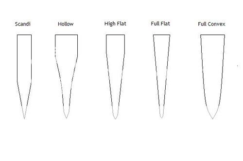

Does anyone ever want a different grind on their Beckers? Or maybe a choice of grinds? From the factory is what I mean.
The high saber grind is probably the best overall grind for how we use them, IMO.
I'm not usually a fan of hollow grinds, but the very shallow hollow grind on my Kabar Potbelly has yet to disappoint me. Putting one on the BK-2 might make it a better slicer.
I'd like to see scandi grind on the tweeners or make a scandi grind choice on the Necker or Eskabar.
I think they are great as they are. If they started getting tweaked they'd lose the original concept of the knife as well as become similar to other knifemaker's knives. I like them they way they are as well.
You can always get a BK11 or BK14 and convert it to a Scandi-Grind edge by sharpening it.
The scandi bevel wouldn't work out right, since they are flat ground. It would be WAY too thin.
each one serves its own.. to be perfectly honest I really like the scandi, but prefer a convex for most of my hard use applications. but if its just whittling I prefer using my Mora.. I'd like to see a FFG offered on a model..
I'd like to see Becker offer a version kinda like GR way back in the day, more of the 'kitchen' bushcraft knife with scandi
but I like em just the way they are.. :thumbup:
I think I would like to see a 3/4 high flat grind, with a V edge.

i'd like to see convexing like on some of the older ones, and certain models where appropriate, they should have other edges.
I now convex mine, I would love to see that from the factory ala BRKT or Fallkniven...

I also second the BK2 FFG - I love me some FFG blades - and with the 1/4 thickness, it would still be plenty stout. Much lighter, faster and better slicer. Make mine uncoated.
