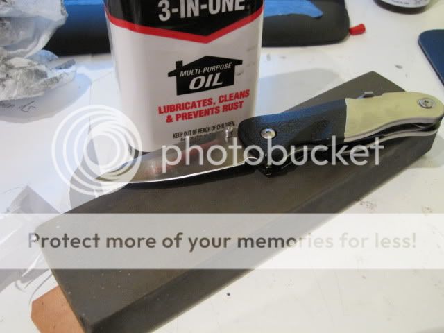

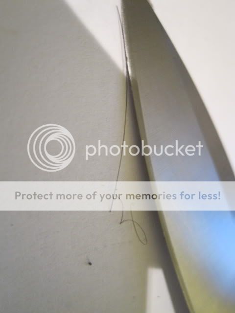

Wow, 154-CM is great stuff!
Its holds an edge great, chewed through many cardboard boxes today work.
Decided to sharpen it.... on an old unknown oilstone.
Man, this stuff sharpens easily, and get very sharp, on a medium stone (compared to those super duper waterstones nowadays)!
As always, pics or it didn't happen.
This is without stropping!
Tools used
Seriously guys, if you are new to sharpening, get a stone and practice. Watch Murray Carter's youtube videos. You will have some nasty sharp knives with a bit of practice!
/end of tooting own horn/
Any idea on the hardness of that blade? How about the edge angle? I can get the same high sharpness edge with just a 1000 grit water stone on my Benchmade 550HG, but have a lot of trouble with other blades. I feel that Benchmade runs some of their steels harder than others, which minimizes burring and makes that kind of edge easier to obtain. I haven't tested this theory, but some of the easiest sharpening blades I've had were Benchmades in 154 CM and AUS-8.
Angle: no idea. The factory angle worked well for cardboard and wood, so I stuck with it. Gettin the burr was pretty easy, maybe 3-5 minutes each side. The motion I use on my stone is pretty much the same as on a Japanese Waterstone. For some reason, I can't sharpen for shit on daimonds yet (i only have the credit card sized ones).
I have no idea the grit of the stone, dunno if its medium, fine, or coarse, i inherited it from my grandfather who brought it from a china.
