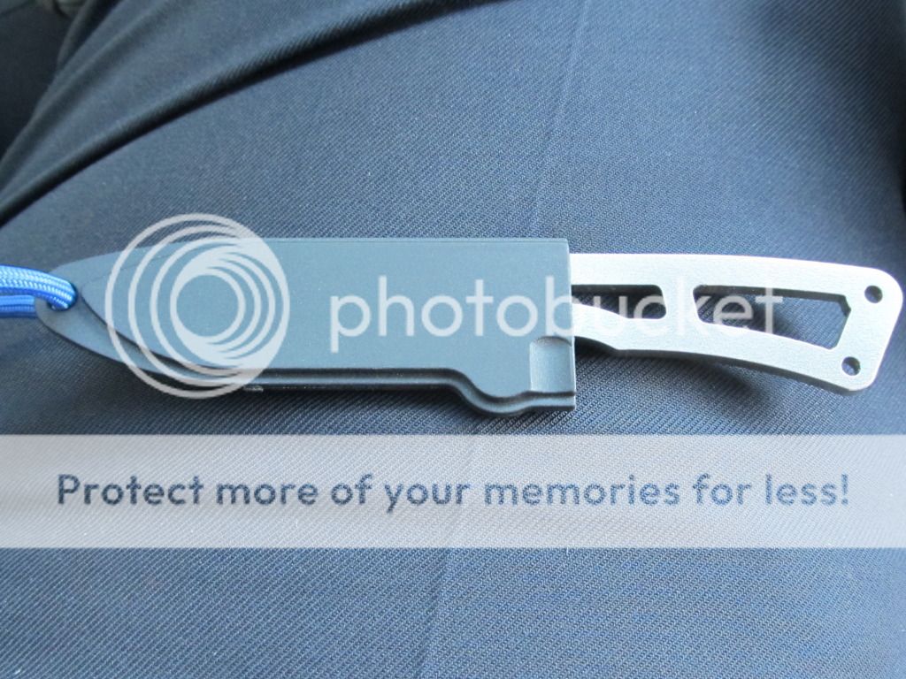

While digging around the house yesterday, I came upon my BK13 that I misplaced some months back. I hadn't done anything to modify it at all and it was just as it came out of the packaging on the day that I opened it. So...........I thought I would post this up for anyone who feels like looking at it or anyone who has any similar ideas for their own small mods. I should also add that I do not know the definitions for every part of a knife so if I label something wrong......I apologize in advance.
First, I started off with the factory knife and sheath.....

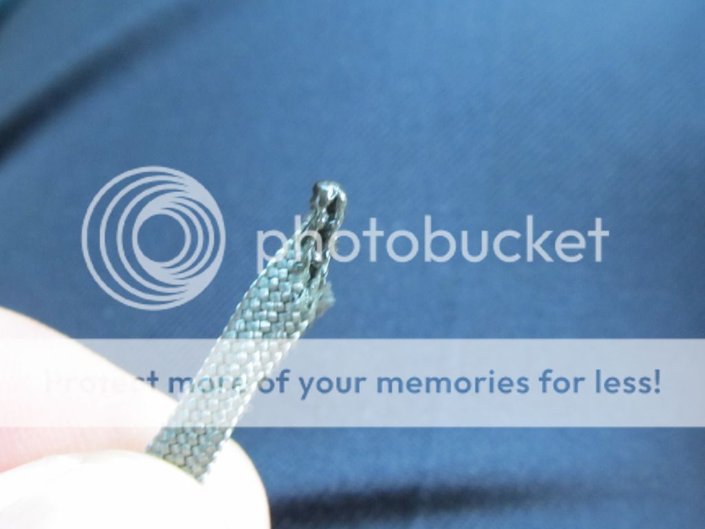

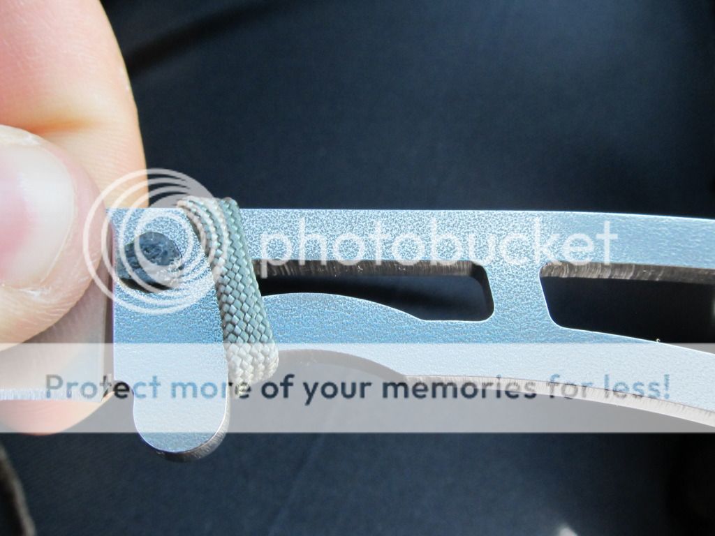

I cut a section of paracord about 3 feet long to wrap the handle with. I started with a diagonal cut and heated it just enough to keep it from fraying so that it would go in the hole easier.

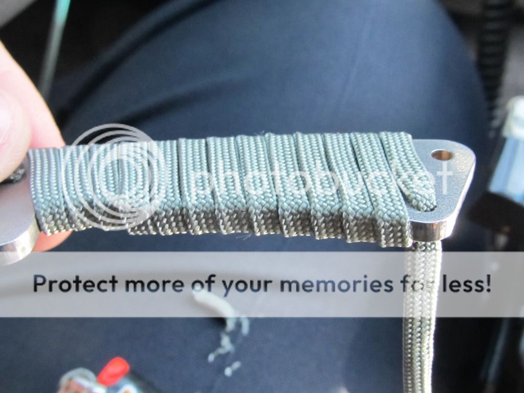

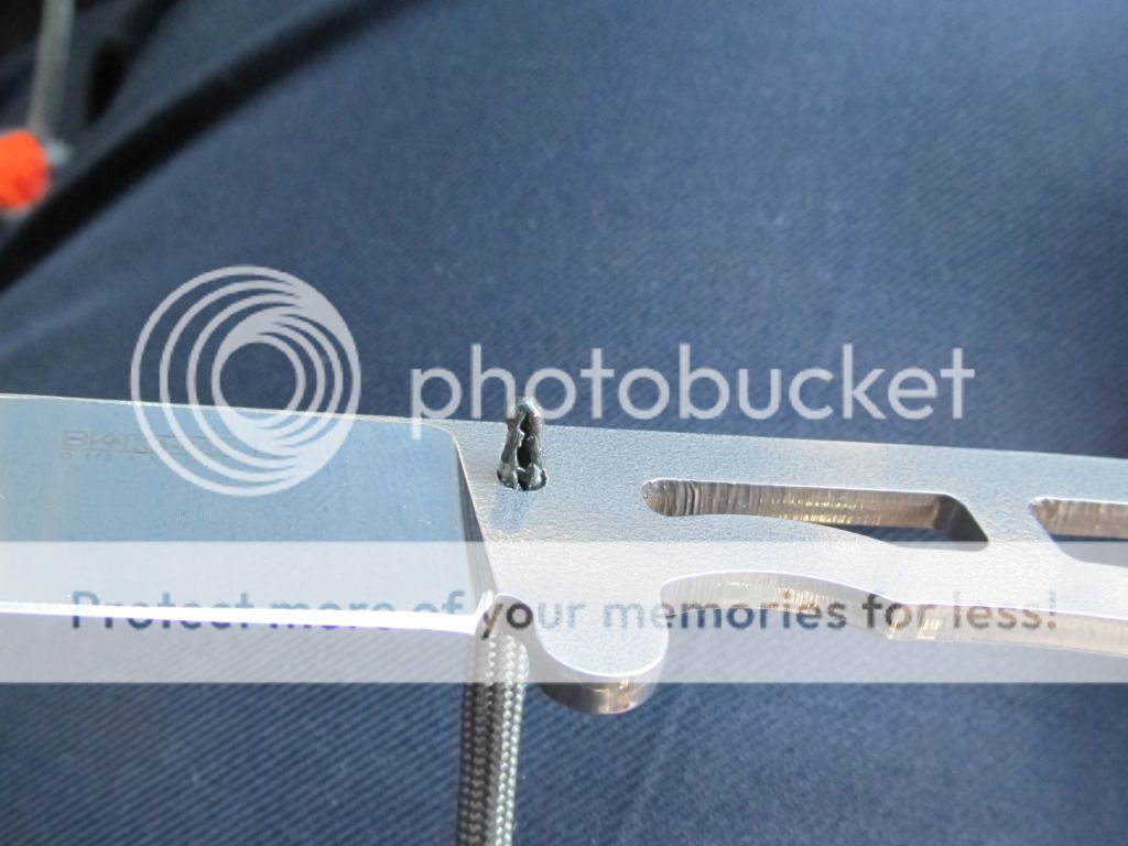

After I got the cord through, I heated it up and mashed it flat. I then wrapped the cord up and over the back of the handle, underneath and back over the top.

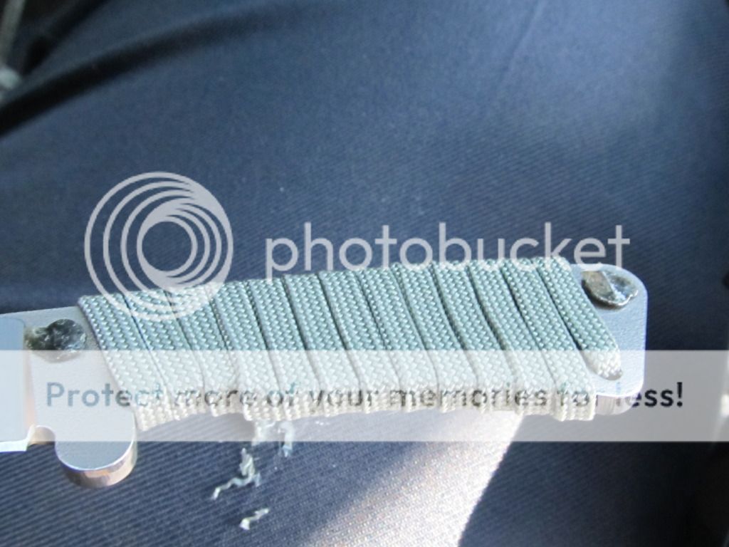

I kept wrapping it in the same direction while making sure to pull the slack out as I went. As I neared the finish, I angled the end of the cord and ran it through the bottom hole of the handle.
Then back up through the top hole at the back of the handle. I ended up cutting off about 8 inches of leftover cord and then mashed the final end flat.

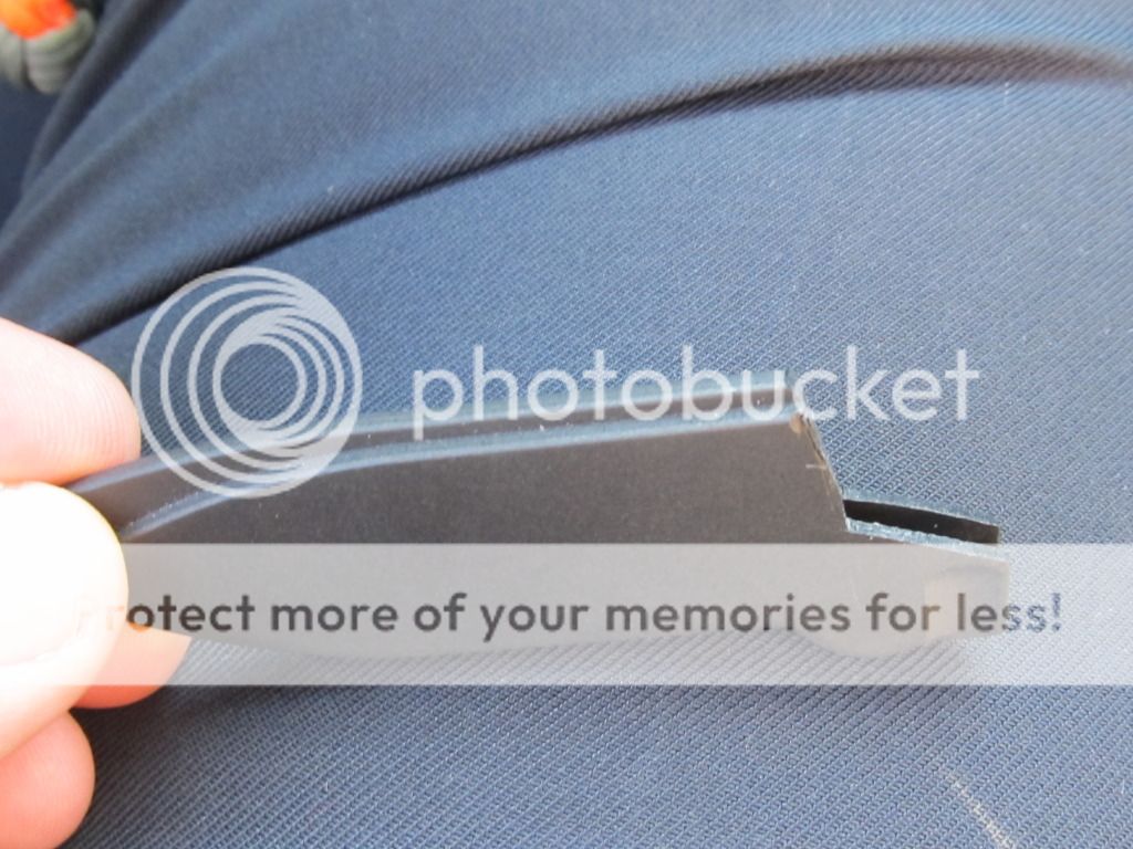

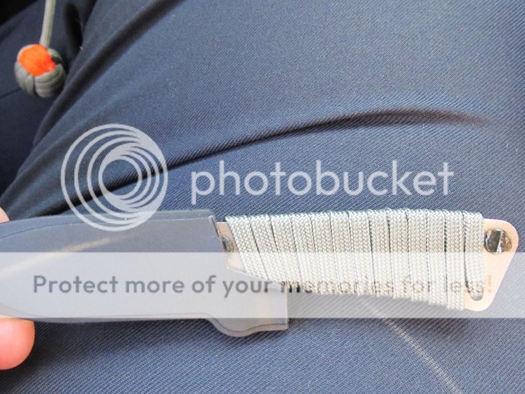

After I was finished with the knife, I had to modify the factory sheath so that it would fit. I cut a small notch out of the top of the sheath and the knife fit right in.

Nice job! Since this is a semi-permanent job, have you thought to run a lighter gently along the interface between successive wraps to help keep the wraps in-place - make it a more solid handle? Just a suggestion - it also might make it too rough.

If you really want to screw up the retention on the sheath, cut the ball off the blade. It slides right in and out of the sheath with no retention :(
I do like your wrap though man. It looks good.
Wintermute - I will probably try that.
Mist - With the way I cut it, it didn't mess with the retention at all.
