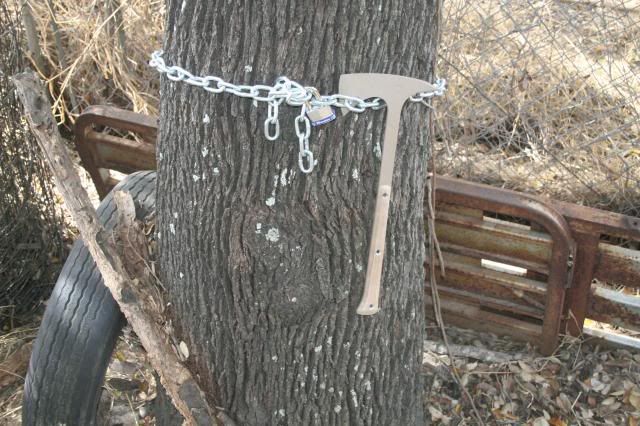

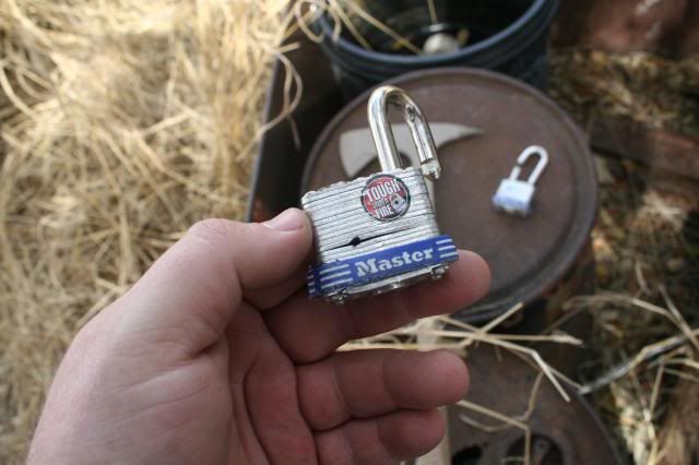

I tried padlock breaking for the first time with one of my Wreckers that I was hanging onto for myself to shoot some demonstration videos later. I wasn't as quick or graceful about it as Ryan Johnson, but I was successful. My spike doesn't fit as well in the shackle of the padlock as the RMJ does. Don't know if that will lead to changing the design down the road or not as busting padlocks is not the only design consideration with them.

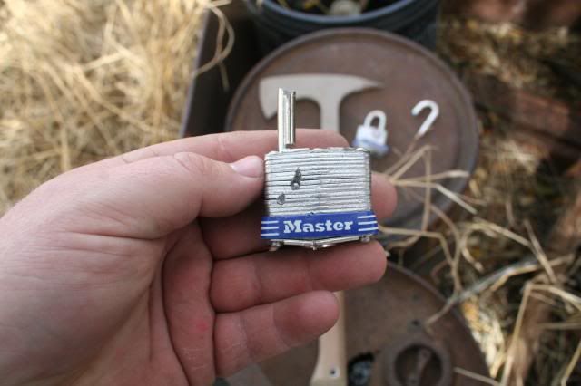

Prior to starting on the lock, a standard Master Lock:

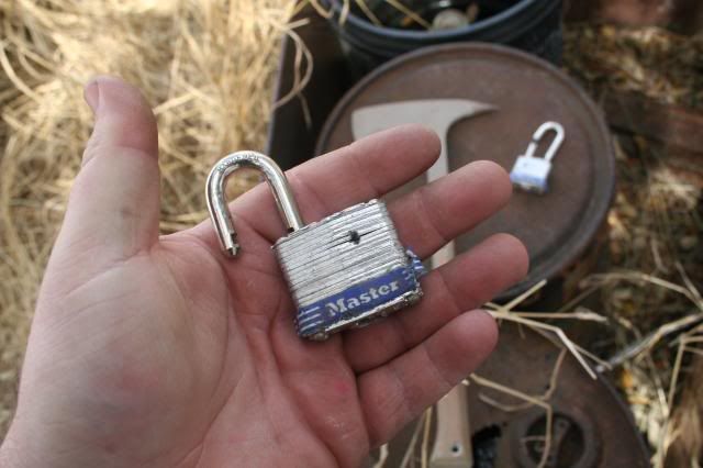

After the shackle broke:

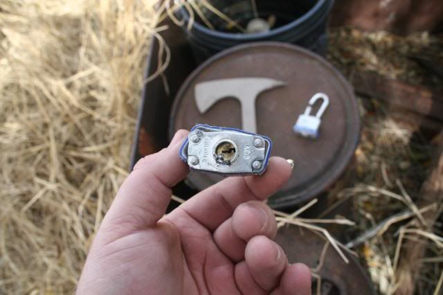

Hard to tell from that pic. Let's take a closer look:
You can see that I struck at the body of the lock with the point of the spike. I honestly don't know if it was prying or striking that broke the shackle. It wasn't a dramatic event and I didn't see it was broken at first.

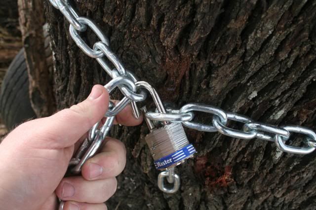

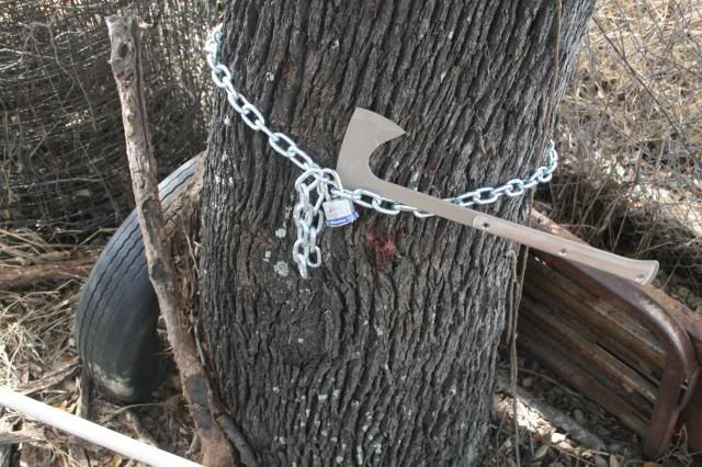

I decided to try it with a lock with a shorter shackle. It was even more difficult to fit the spike in with the heavy chain links. I ended up striking with the spike until the lock popped open. You could not re-lock it afterwards due to the damage.
Here's a close look at the longer-shackeld lock:
And the various places on the shorter one that got hit:

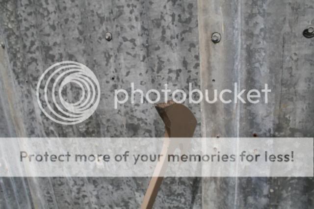

It was hard to get my camera to focus on the end of the spike's point, but you can see that while the steel wasn't untouched, it almost was exactly like it started out.
