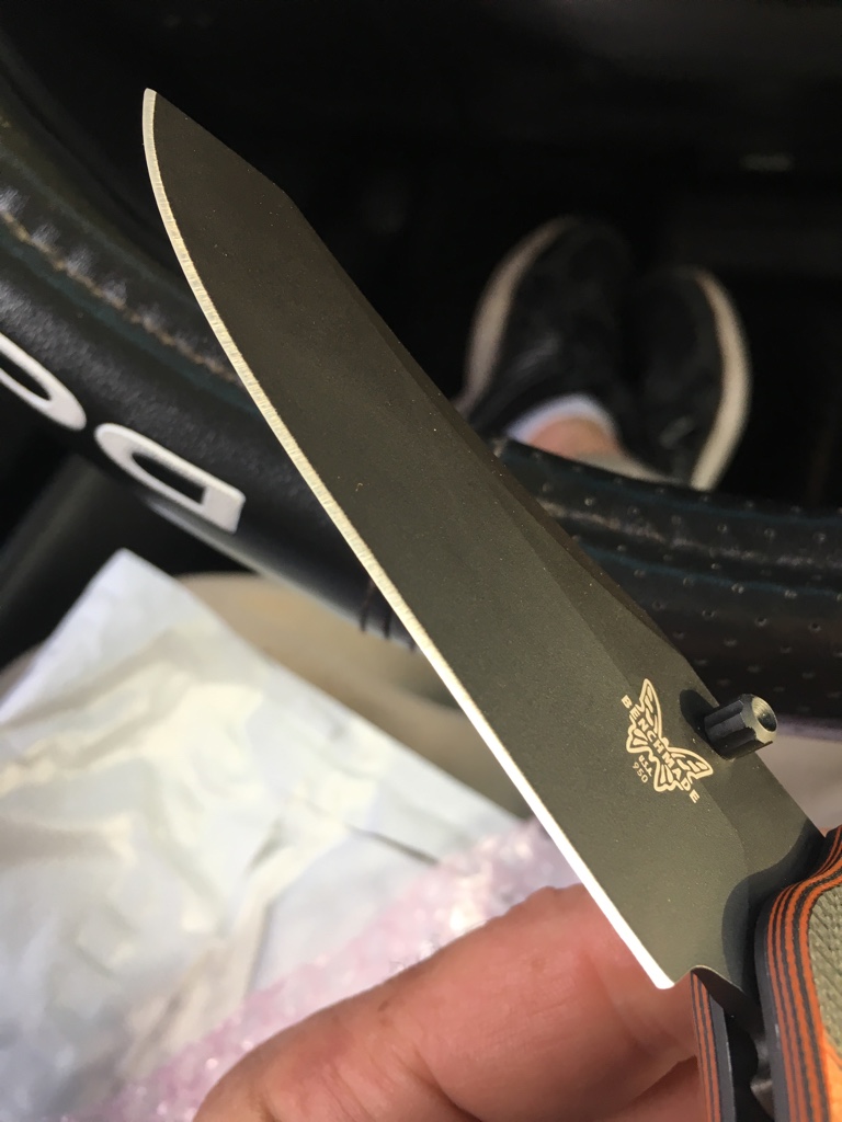

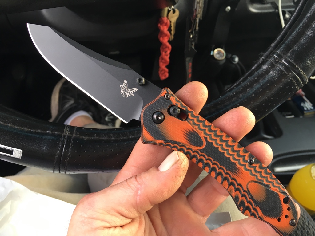

Just took delivery of a brand new 950-1501 with a coated blade yesterday.....it did the same exact thing for about 2 hours.
I hit the pivot and the lock bar with Ballistol. Flicked it about a gagillion times. Then a bit of blue lube and she's a free dropper now!! It's like a metronome when you hold the lock open!!
What a sweet and seriously smoooooooth action!!
Pics......cause knife porn is good!!!
[emoji16][emoji16][emoji16][emoji16]
Joe
An absolutely amazing edge out of the box!!
Looooove that color combo Steve!! Gorgeous Grip!!
Joe
Thanks, Joe. There's another pair just like these in the mail from Igor to fit my black, sheep foot mini-Grip. I'll probably get 'em when I'm get home from VT. I'll post big and little brother to our sadly dormant Pics of Pairs thread.
