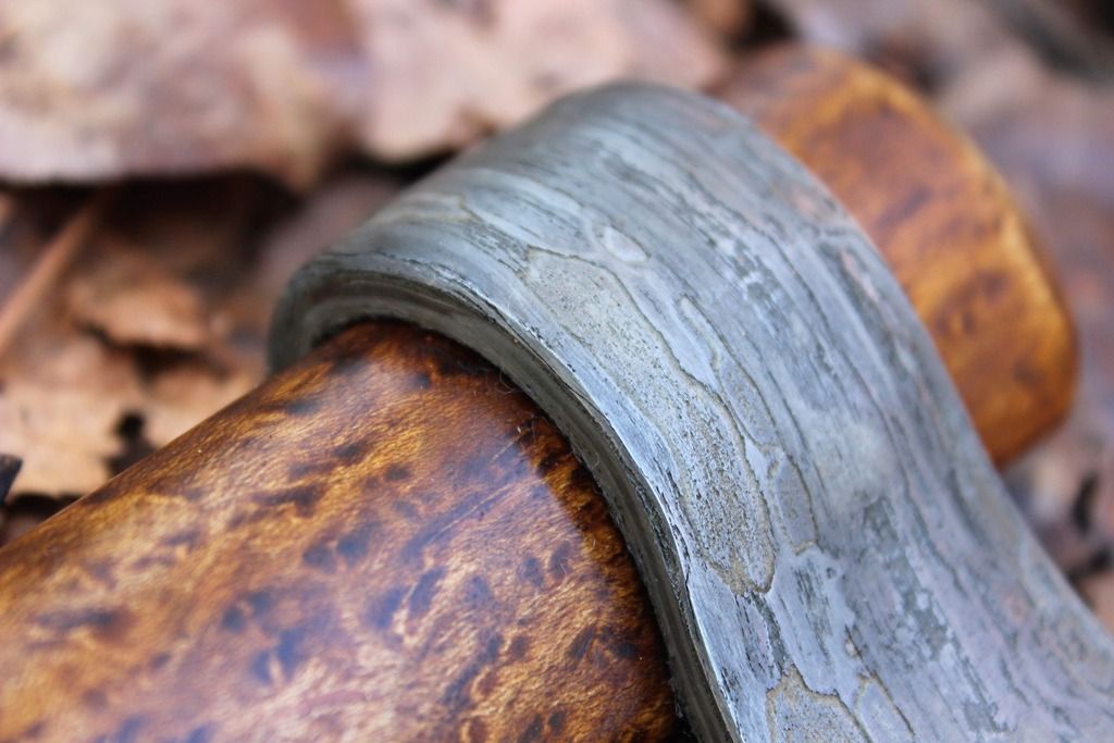

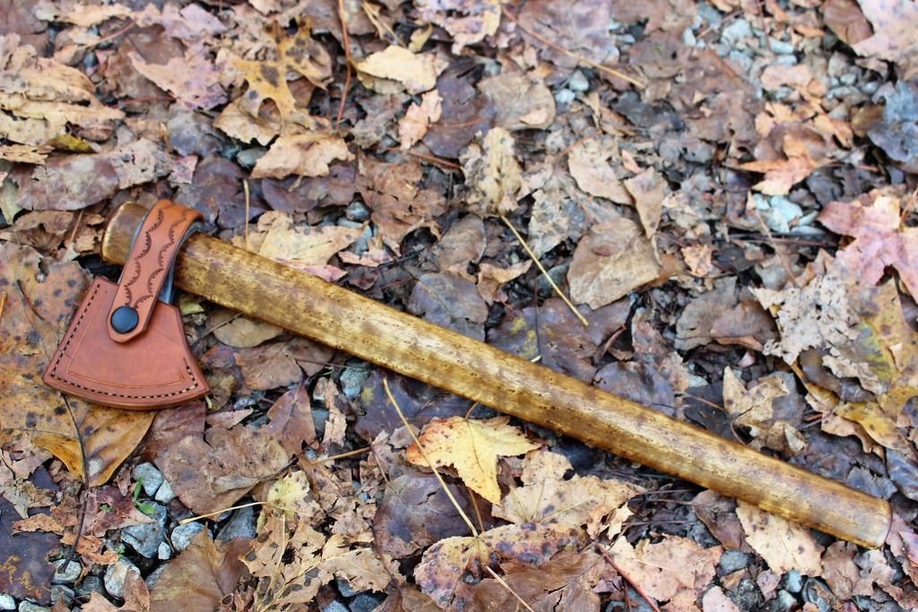

Most recent finished tomahawk.
Wagon wheel wrought head, with forge welded 1084 steel bit, with a gorgeous birds-eye maple handle.
You can see more of my work, including hawks, knives, and blacksmithing work on my facebook page, Eagle Eye Forge.
Are you trying to say OAYS, your body is from old wagon wheel banding? That is beautiful stuff and I for one would like to see a cross-section shot maybe at the axe's bevel would be good.
Yessir. I found 2 old wagon wheel bands buried in my wifes, grandparents, family barn. This is forged from a slice of one. I'll try to remember to get you some closeups tomorrow (you're lucky, this one hasn't found a home yet, so I can take more pics, lol). Are you wanting like a shot of where the wedge is welded into the wrought?
Did you have to etch the metal to get the wrought iron grain to show up?
Yessir. I use PCB etchant (from Radio shack... bought 3 years before they shut down... man I need new stuff, lol) mixed with distilled water. I treat wrought basically like it's pattern welded steel. I grind, polish, etc. Then clean it, and soak it in acid for several hours minimum (I think this head got a good long 6-8 hr etch if I remember correctly). You can see faint hints of the pattern before etching, but for the most part it looks like a blank chunk of steel, maybe with some tiny inclusions here and there.
