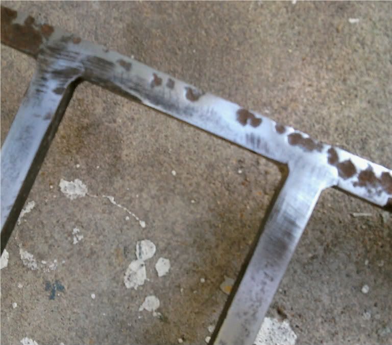

I went looking around a few salvage stores here in New Orleans for some wrought iron. I found plenty of pieces of porch railings, fencing, burgler bars and plenty of other types of things that they call "wrought iron". Most everything is painted. If it isn't painted or where the paint is gone, it's rusted. Some surface, some pitted. Is there any way for me to tell what is wrought iron and what isn't? One of the workers said that wrought iron will be solid and not tubular and heavy for the size of the piece. Aldo showed me a piece that he has and pointed out the striations, or grain, that it has in it. Some of the bars are straight and square and look like they might be factory made. Some are straight and square with decorative scroll work on the ends, like the first picture. Thanks for any suggestions offered.
Rob
These grapes are heavy and are pretty much look identical to each other. The guy there in the store said that they are wrought for sure. I didn't see any lines on the sides to indicate that they were poured in a mold. They are solid pretty heavy.
These things are heavy as sin and very heavily rusted as you can see. The grape vines are a single piece. The bar stock on the top and bottom are screwed to the vine piece. The vines are solid and the bars are solid as well.
I did pick up a small set of burgler bars. Just by the fact that they are burgler bars, I'm guessing that they are probably not wrought iron. I sanded down a small area of the metal. I did see some marks that might be the grain or it might be marks left by a grinder after grinding off the welds. It is now in a paint stripping tank. I'll get a better look at the metal when the paint comes off. Any suggestions on how I can tell wrought iron from just old steel?
Sorry for the crappy pics. Only had my cell phone.
None of that is "wrought Iron". It is what is called "Ornamental wrought iron". The real wrought iron would most likely never be painted black . It is going to be pieces from 100+ year old hinges, bolts and straps, and specially old anchor chain. To check, take a piece and cut half way through it. Stick it in the vise and bend it 90 degrees. If the break looks like cracked wood, with lots of fibers and striations, it is wrought iron. If it just cracks in a random pattern, it is just steel. Once you see a piece of wrought that has been break tested, you will never mistake the ornamental black stuff for the real thing.
