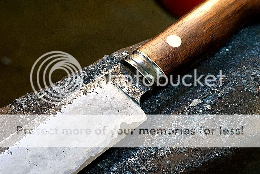

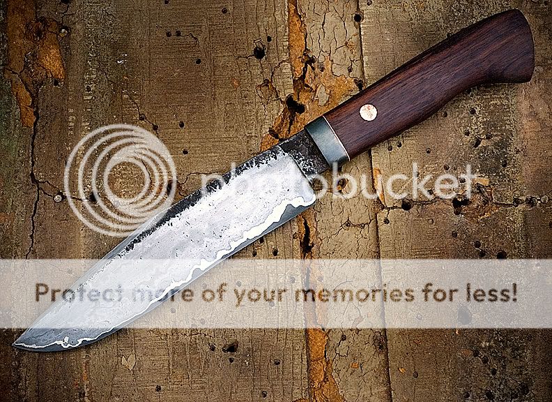

This one is 14.5" OAL, with wrought iron/pure nickel/1080 san mai blade. The ferrule is W1 cold blued. Copper spacer and giant, peened copper rivet. East Indian rosewood handle.

I'm gonna be posting an updated photo later. I decided to do a make-over. Something just wasn't sitting well.

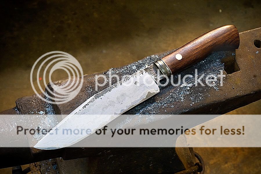

I decided I wasn't done with this knife. So I narrowed down the handle, made the ferrule more stream-lined and did some carving on it.
I'm happier now...

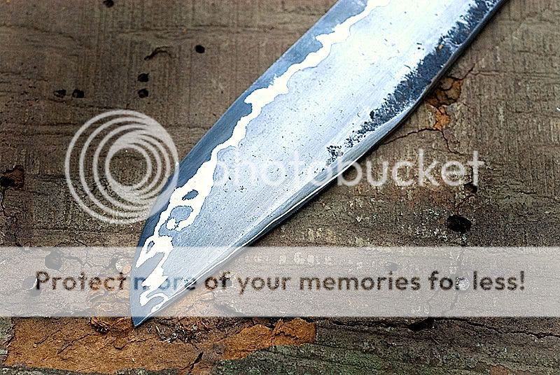

Great job on the blade. That isn't very easy to keep the core centered is it? I hope you are charging double for all the hassle.

Thanks guys...
Yeah counting hammer blows isn't easy for someone like me to stay focused on. But... the press is almost complete.
