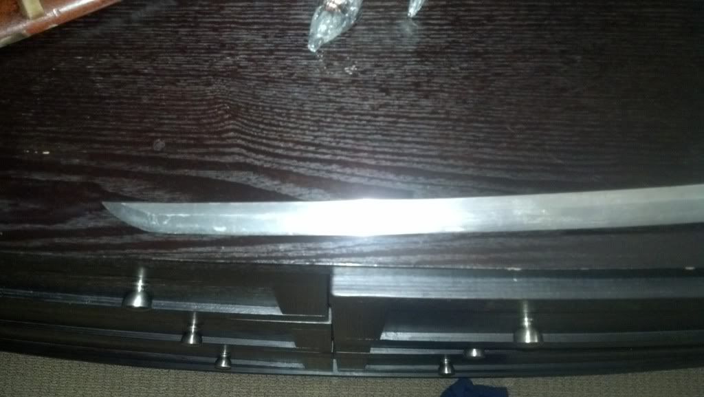

my much older cousin gave me this sword that his fellow officers gave him as a discharge present, sometime near the end of WWII while stationed on an island in the pacific...
i have no interest in selling it, but i am interested in finding out about it, its quality, history etc...

From your pictures, it's impossible to say anything about the blade itself.
We'll need to see pics of the full blade without fittings to judge its shape and a picture of the whole tang on which there maybe an inscription.

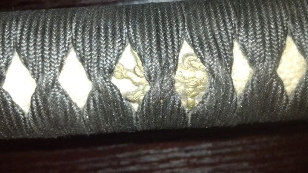

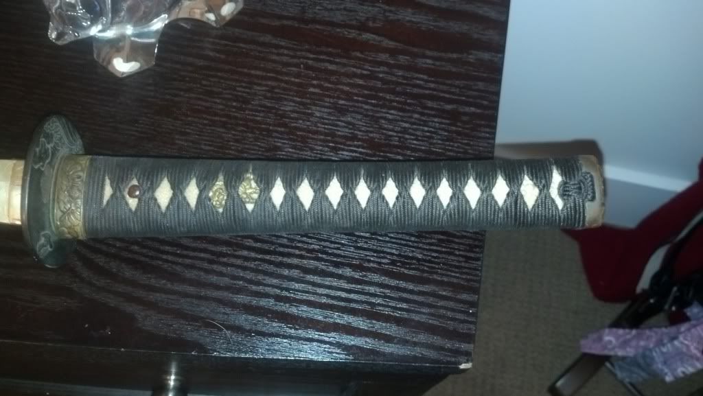

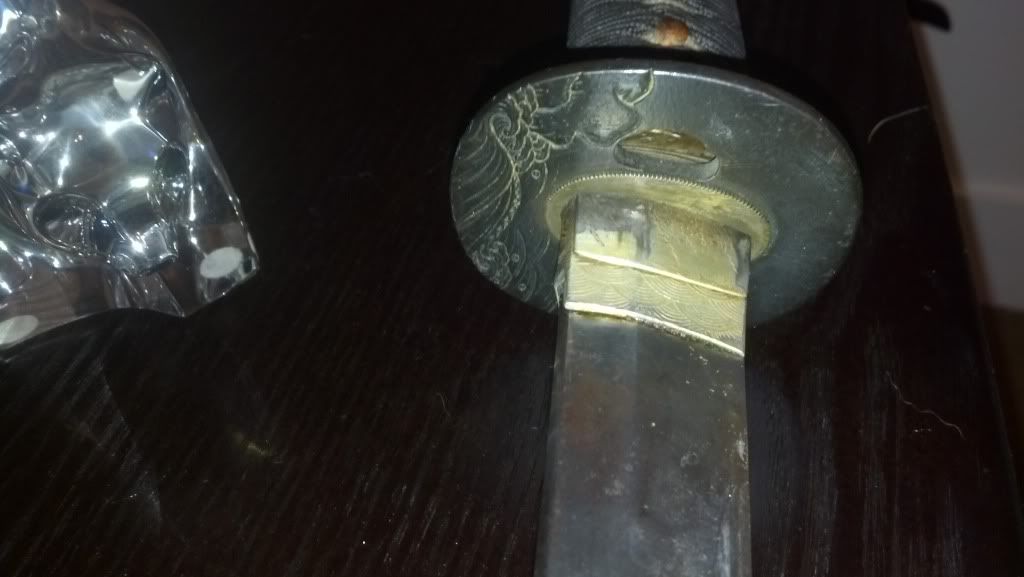

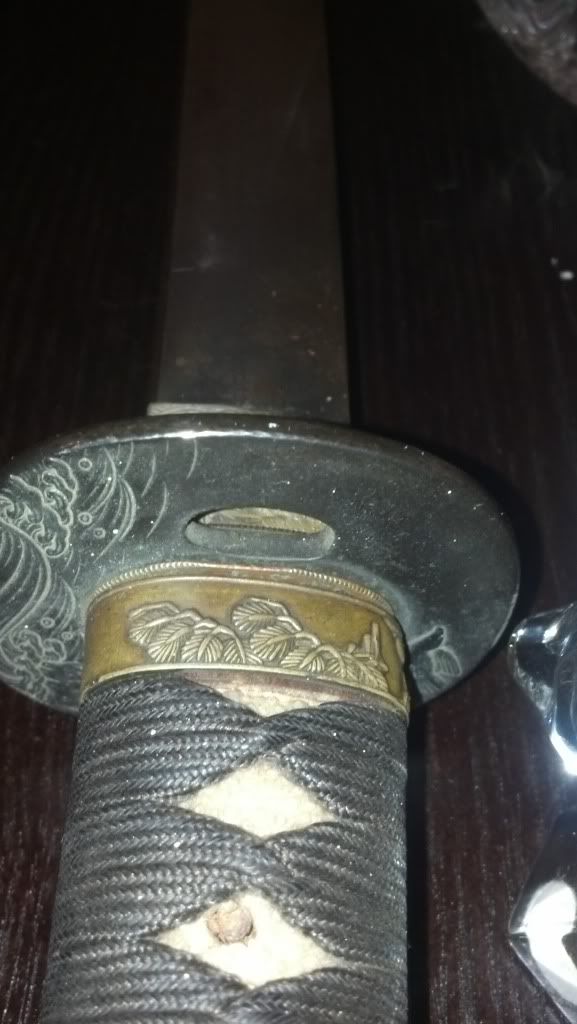

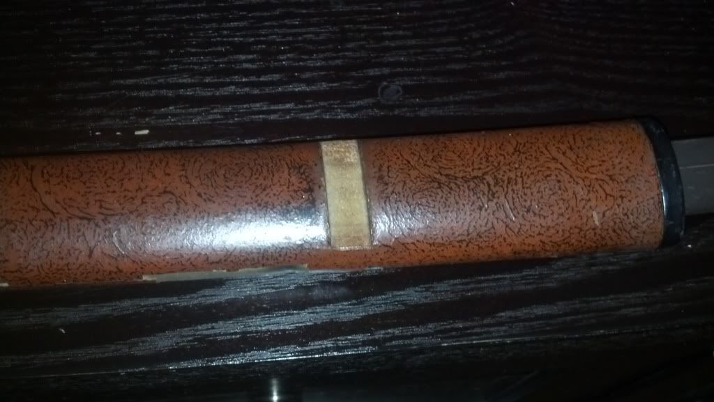

The fittings all look to be authentic. None of it looks to be WW2 style but from an earlier period, probably mid to late Edo, 1700's to 1850's.
Quality looks to be good though not top level and the condition is good.
The habaki looks to be interesting with the wave pattern carving. The rain fall pattern on the lower part is common but the waves on the upper part are unusual.
