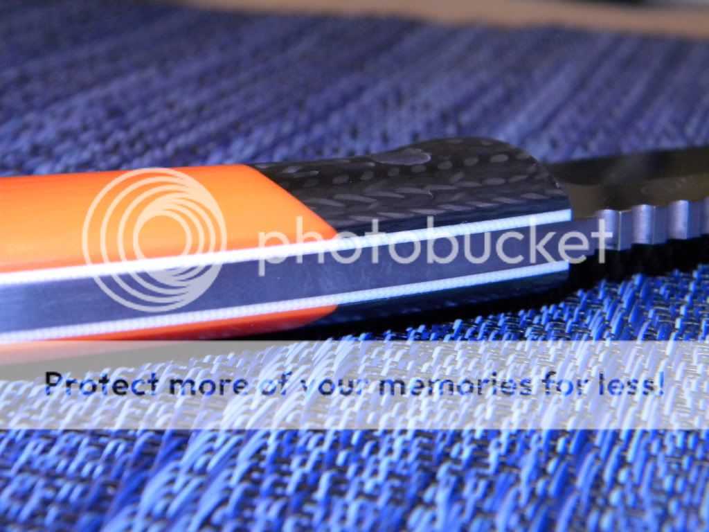

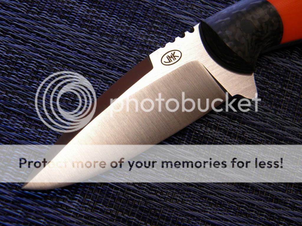

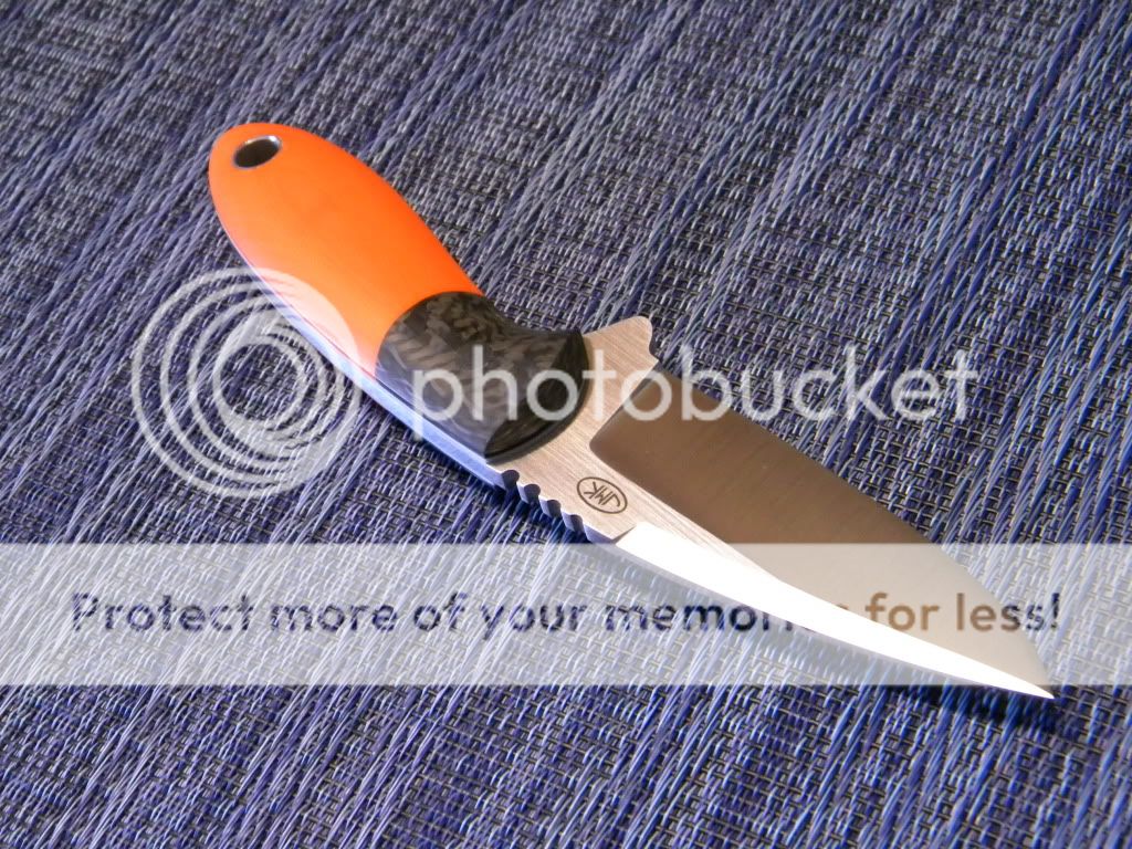

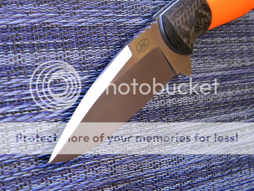

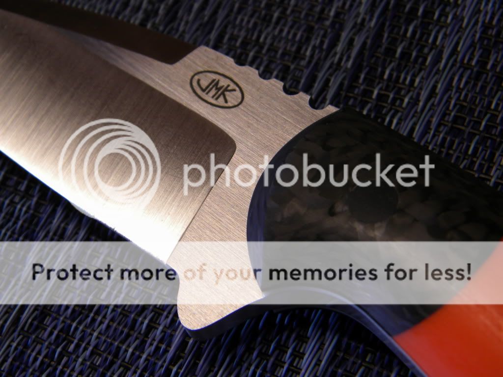

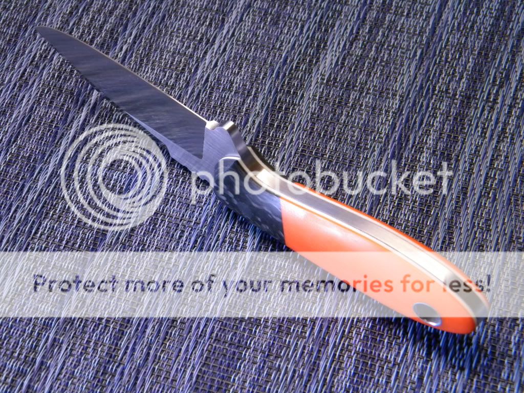

I don't know why I've never done a bolstered handle before. I like the way I look and it didn't see too daunting of a project, but for some reason I had never done one, until just recently.
Here is a modified Model One with a longer handle and blade, a bit over 8 inches overall length in D2 tool steel with dovetailed carbon fiber bolsters with a black glass pin, orange G-10 handle slabs, and white G-10 liners, hand sanded to 800 grit.
I like the way it turned out and plan on playing with some more bolster/slab combinations really soon. This one should be with me in Vegas in Sept.
Thanks for looking guys!

Like to see the bolster in steel or titanium....I was always of the opinion that anything but(damascus, timascus, mokume...excepted) was a lazy ass move.
AND...please, for fuks sake.....taper a tang here and there...willya?

Tapered tangs?........I know, I don't do enough of 'em. Let me see what I can do!
The carbon fiber looks great. It keeps the weight down and gives a nice contrast. While tapered tangs look nice for a user like the one you have there a full tang is a much better choice if the butt ever needs to be used for giving something a whack in the field.

One question though. Why not hide the "pin" on the bolster as well (assuming there are hidden pins in the handle)? And also agreeing with STeven on tapering the tang.

There are no hidden pins on this knife. The orange slab and the CF bolsters are epoxied to each other and to the liner material before the knife is glued up. In addition to the usual divots I drill in my slabs and liner material, there are some small divots drilled into the 45 degree cuts where the pieces dovetail together for expoxy to collect in and strengthen the bond. The front pin and the tube in the butt are there for lateral strength like usual.
I've been meaning to play around with some hidden pin designs though. I'll get on that soon!:thumbup:
