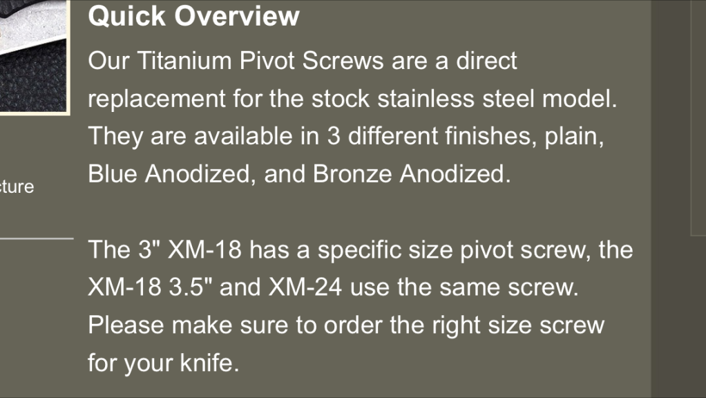

I have a xm 3 titanium pivot screw and a xm.3.5 warnie on its way to my house.will the xm 3 titanium pivot screw bronze fit in the xm.3.5 warnie.I checked the hinderer website and it only gave one size for the pivot screw.if not im stuck with a xm3 bronze titanium pivot screw.I guess I can allways trade or sell it
It will not fit. Sorry man.
Most all the hardware only works on 1 size knife, which few exceptions.
Screen capture form the Website pivot screw order page...
By the way, the 3" pivot screw does fit in the 3.5", the threads are the same. It will be slightly shorter (the 3" pivot screw is approximately 0.85" shorter than the 3.5" screw or about 83% of the length of the 3.5" screw). Despite the shorter length, there is more than sufficient thread engagement to work properly, the only issue is that it will not fill out the pivot barrel nut as fully as the proper screw.
