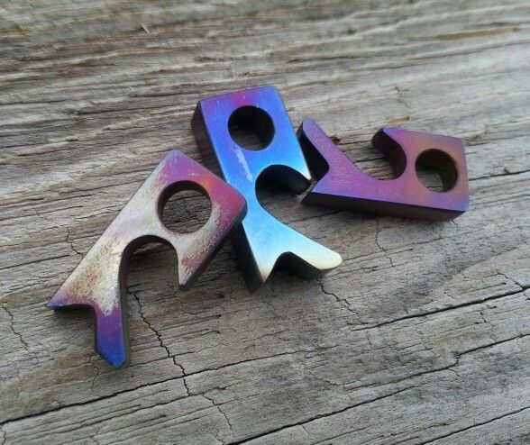

I posted this up in the sales thread for em too, but thought I'd post here too since y'all helped name em. Very colorful batch. I try to leave minor machine marks and them knock em down with a wire brush. It gives a little variation to the color due to thickness variations and whatnot. Then just a little hotwork and letting the oxide develop color... The gold/purple one was heated and then brushed on the edges and heated again to give it a different appearance. The purple is my favorite so far...
Going to start incorporating this into my knifemaking I think. Haven't used enough titanium...
