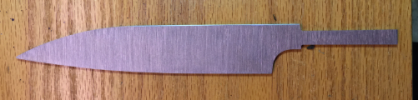

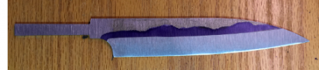

I have long wanted to own a Yanagiba, but never took the plunge. a while ago I bought some 26C3 from AKS with the intent of taking a stab at a Yana. I thought my skills were at a point now that I could take a stab at it ... and so recently profiled it, and today did my pre-HT initial grind on the bevel. Pictures below. the steel is really too short (200mm blade) for a true Yanagiba, and the profile I now see is not really quite there (the spine is straight for too long a stretch - but I can re-profile that down after HT. Mostly I was concerned about trying to keep a clean Shinogi, and it turned out .... not bad. Just a little wave, but I have post HT refinement (and likely EDM stones) to get the final product clean. Will post again later. If this turns out ok - I will likely take a stab at a longer 270mm or so blade
(dimensions: thickness - 0.145 (a little too thick), pre HT edge ~0.024, pre HT grit - 120)
Oh - I do have a contact wheel, but I am not sure at all how to go about grinding a clean concave urasuki on the back of the blade. recommendation would be most welcome!

Now that I have finished that first "learner" yanagiba (and learned mis-steps along the way), I am going to resurrect this thread for next steps - my "holy grail" of a 300 mm Yanagiba (this time with correct blade dimensions). Given that Yanagiba are usually much less high than my first attempt, here is a proposed profile for a 300mm blade this is meant to follow more correctly the typical profile. 1.4" high at the heel, the tang is 3" long.
Any comments/suggestions for changes? I have the steel in now, so can cut this out any time.....

My suggestion as far as shape is to slightly increase the length between the machi and the heel and I would tighten the radius of the choil, looks like maybe a 1/2” radius, I’d try a 1/4” or 1/8” radius for a more defined look.

Yeah - I see the more typical smaller radius on the choil. I do have one smaller small roller - i'll adjust the radius so I can use that smaller roller. Thanks.
I'll need to think about/play with whether to increase the distance between machi and heel. I pretty much settled on that distance for my own comfort a year or so ago, and since this blade is for me...... Nevertheless, I will take a second look at how a longer distance feels to my hand.

It actually was easier for me than I thought it would be. The thicker stock makes it easier to pin the shinogi and keep it straight. grinding the Urasuki also was much easier than I thought it would be .... but you DO need a radius platen to do it.
This is a longer blade - so we will see how grinding it goes. I AM going to try the "metal tab on the tip" approach on this one - it seems like using that will make things much more stable when grinding at the tip....

Ok - I have a 1/4" small roller, and modified the choil to reflect that smaller radius. I like it - thank you for bringing that to my attention!

Grinding the ura *really* was easy ... it was just the long lever arm from the handle out to the tip when grinding the tip that made for keeping it centered a challenge. I am hoping that using the "tip tab of metal" will help a lot with this.
This may sound strange ... but i found making this style of knife to be much less challenging than making a long, thin, full flat grind blade. The thick stock makes keeping that relatively short bevel uniform and the shinogi crisp *much* easier, and as i said, grinding the ura was surprisingly easy (not a lot of material to remove, and because you are grinding against a *thick* piece of metal, heat buildup was hardly a concern). That first attempt of mine took so long because other stuff kept getting pushed up as higher priority, not because it inherently took a lot of time itself.
