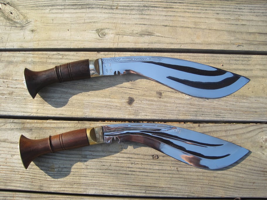

Next, both blades in un-touched (mostly) beauty. Tirtha's at the top, and Sanu's at the bottom. Already there are obvious and striking differences, but Tirtha definitely nails the "spirit" of the YCS. The variations are in the details.

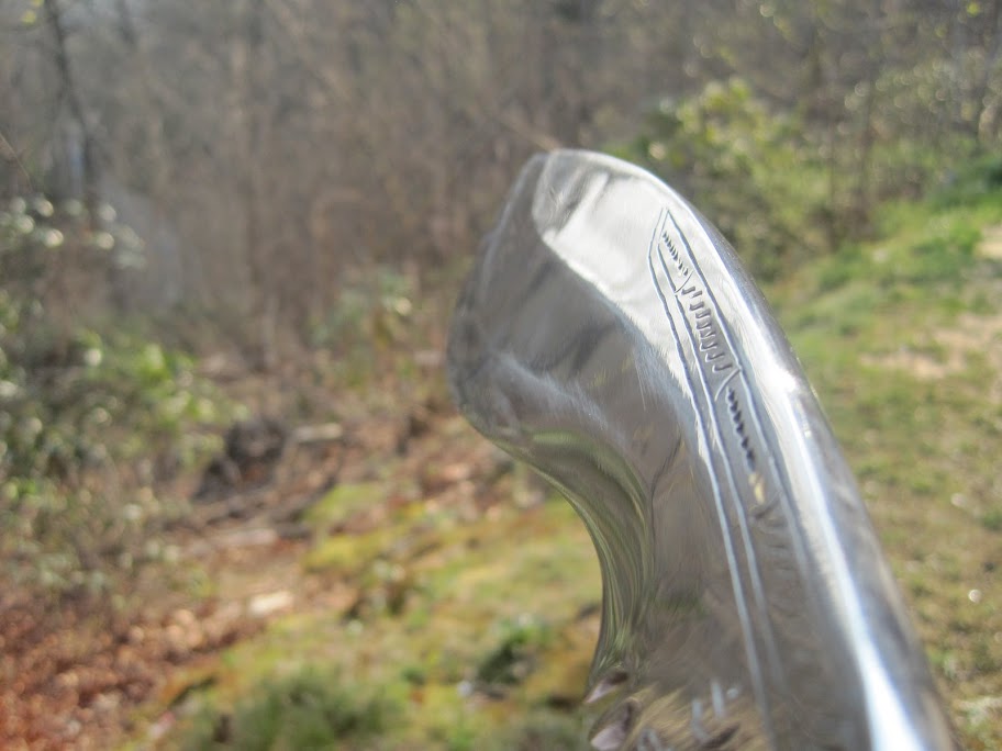

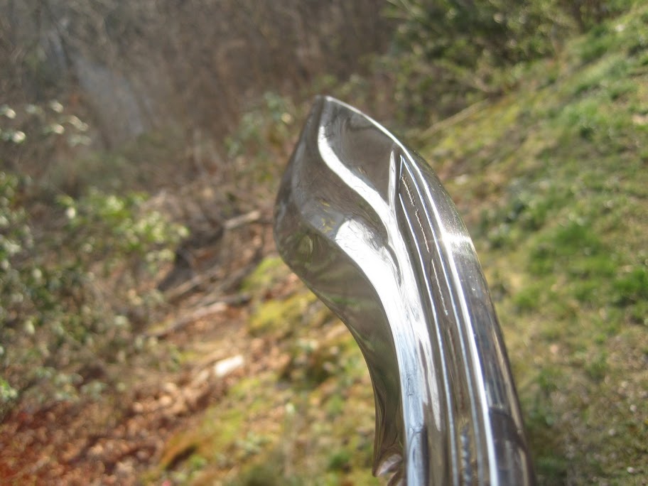

But here you can see the difference in the spine profile, and in the 2nd photo, the extreme difference toward the tip, which bear in mind, directly reflects the intersection of fuller to edge and grind:
