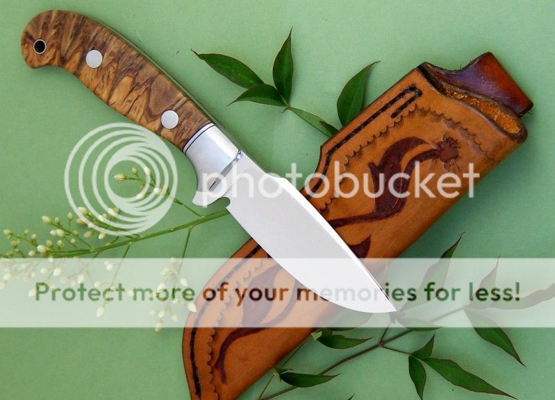

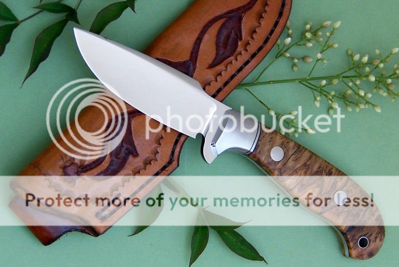

Blade is 3 1/2" ATS34 raised clip Mirror finished., dove tailed bolsters and spacers is G10 and 416 and handle is Yellow Box Burl.
Thanks foe looking and all comments welcome.
Art, your craftsmanship is always top notch, and you know I am a fan of your work. This one though, something about that large spanish notch next to the guard looks a little funny to me. I don't know if the notch makes the guard look bigger or if a longer ricasso would help break it up. I do like the look of a dropped edge with the raised clip, though. It is a smaller knife so I understand not having much room to play with, but it just kinda stands out to me.
Great work!
-Xander
Art, maybe one or the other might suit my tastes but from a fit and finish point of view, I see nothing to complain about! I think if the ricasso were shortened up, basically coming straight back from the notch and have the guard follow the shape of the bolster might make it a mean looking little hunter! I hve a similarly shaped piece I'm working on that's a bit bigger (6" blade) and I really struggled with the guard/notch area.
I'd like to talk to you about a knife, do you take orders? I can be reached via emal at fast14riot@gmail.com
-Xander
I think we are talking two different ideas. I was talking about shortening from edge to spine direction. Bring the edge side ricasso up to the plunge/notch intersection and bring the exposed tang part of the guard back to follow the shape of the bolsters. Creating a narrow waisted knife.
I hope my comments about your design are taken just as a running commentary, and not as critical of your work. As I have stated in the past I am a big fan of your style and can hope to get as good as you someday. I just like discussing your designs with you to help in my own making. You seem to favor 4" knives and less, which I also really like, you use fine materials with flowing design for all around great looking knives. Your little white handled and engraved B&T knife was really a catalyst for me to make knives.
Cheers!
-Xander
I'm going to have to think about that, I drove 500 miles today and I'm a little dense tonight. I try to get the guard to follow the front edge of the bolster , but sometimes I get a little lazy .
You are welcome to talk about anything on my knives and even if it is critical. I can take it. hee hee I really think it's good to be able to talk abot anothers design.
