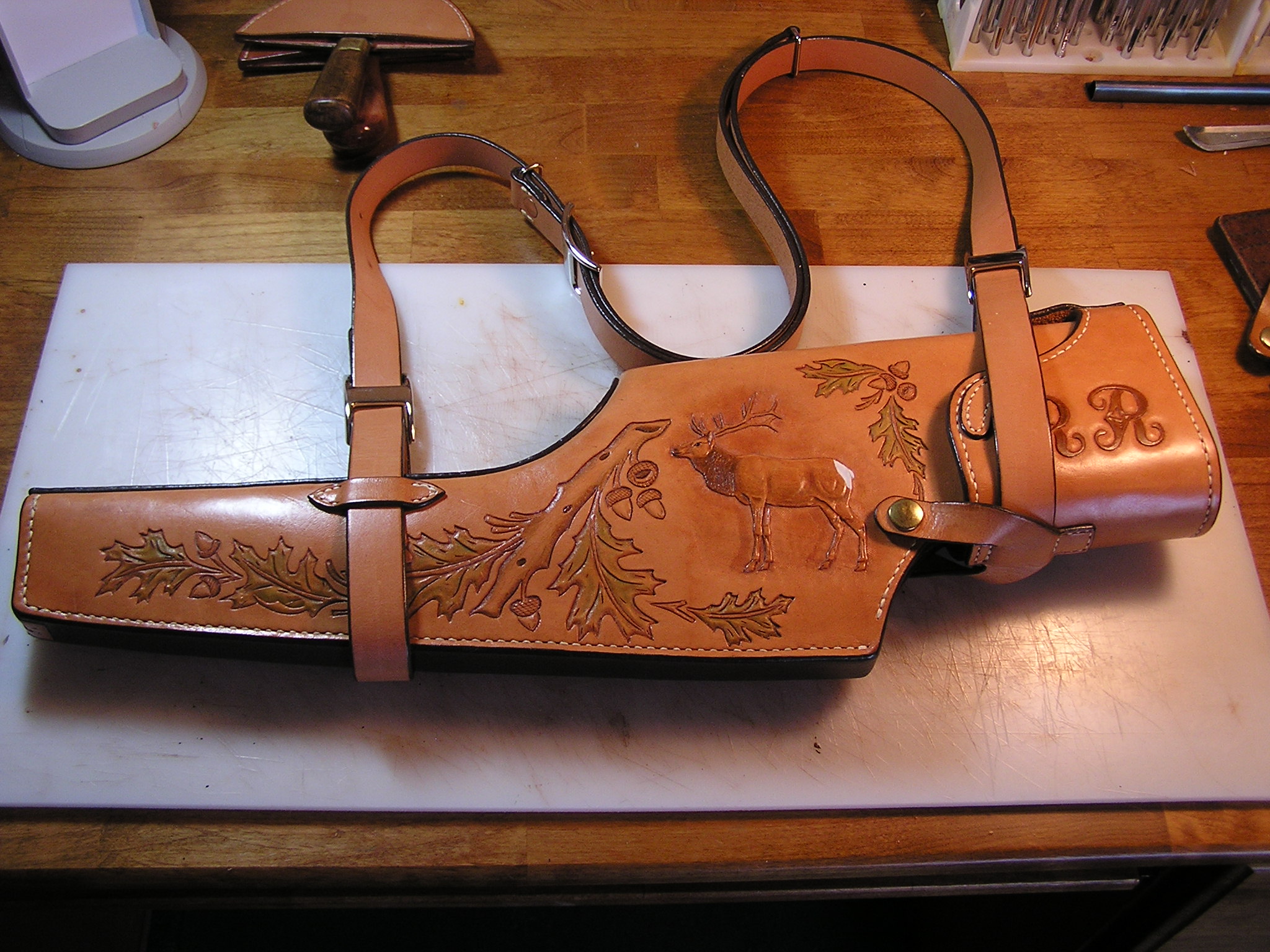

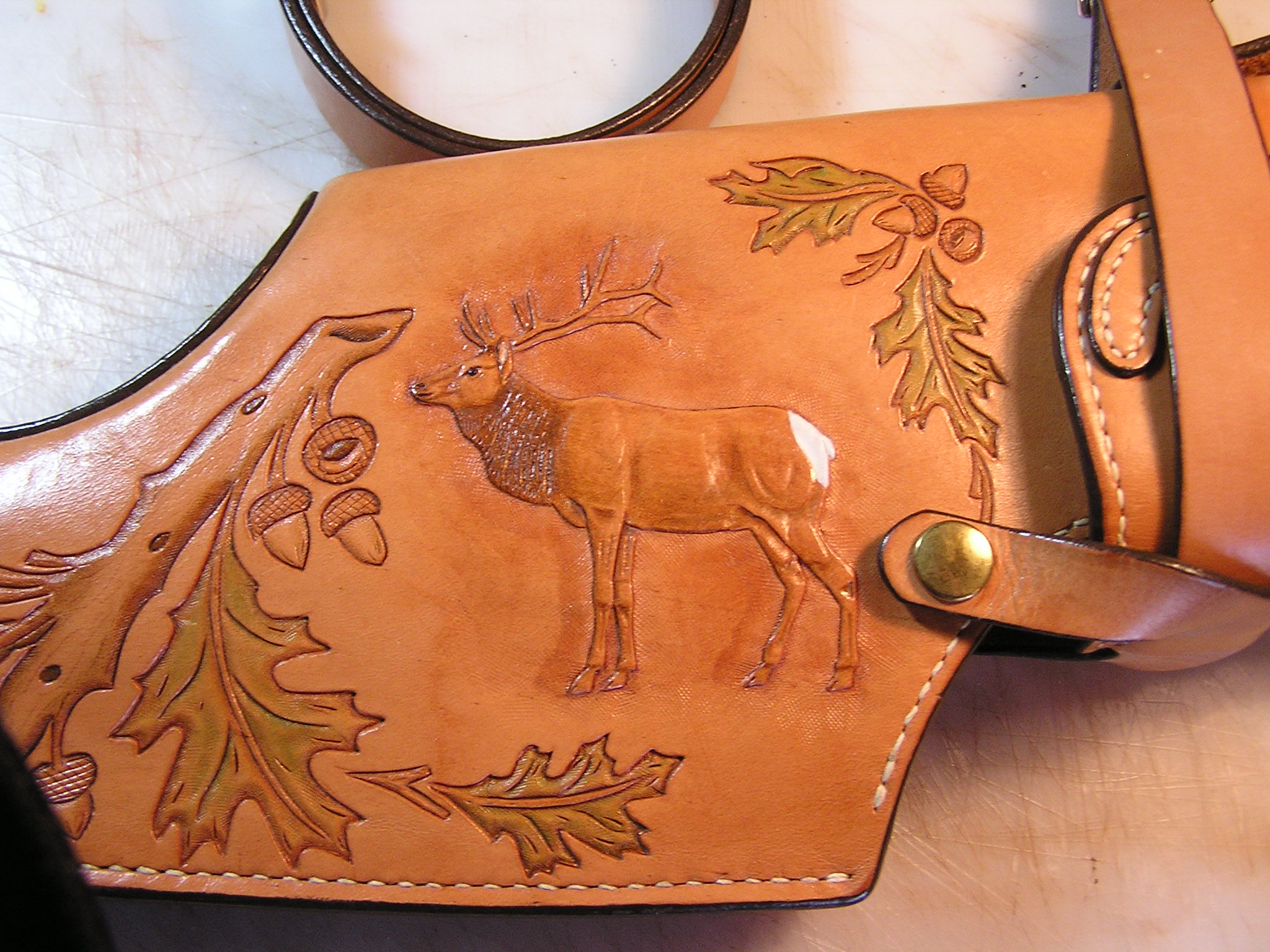

You could say that. But it is more a matter of how long it takes you on your piece. Drying leather is not good when carving or stamping so it is a matter of judging what you need to keep it in the state needed for your work. I was working on this. It has two sides. Not my perfect but it met my needs at the time.
