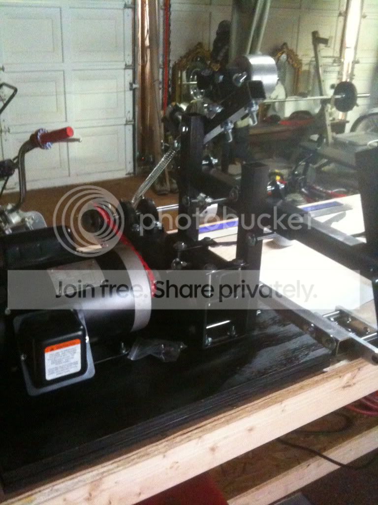

I've completed my build on the No Weld Grinder with the exception of the wiring.
I am completely stuck. I don't have the slightest clue on electrical wiring and I'm admittedly a little nervous about it. I've read though the search results however it just adds to my confusion as each one if a little different.
Here is the information on the motor

As far as the wiring for the house garage, these is no 220 to the garage and the plug is not GFCI protected.
Anyone here familiar with this type of situation that can walk me through it and give me an idea on a parts list?
