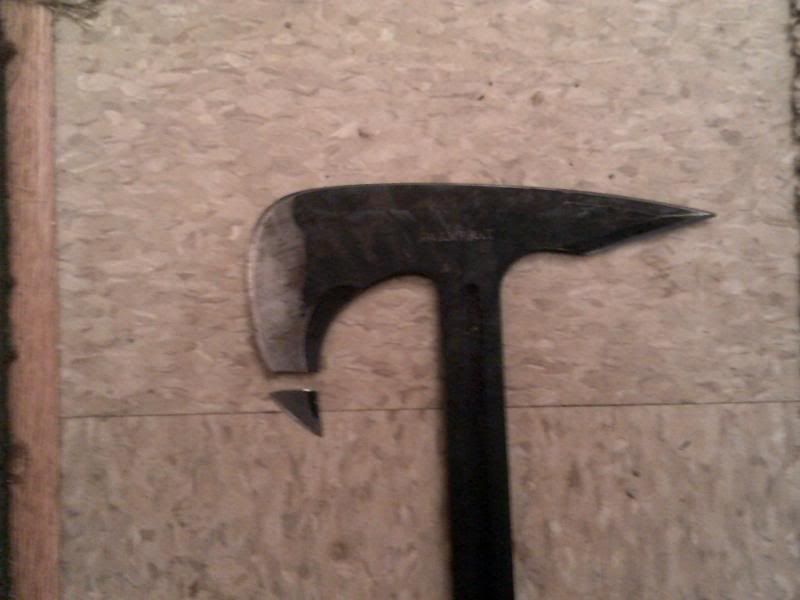

Found this in the Swamp Rat section. It was bent chopping wood and when the owner went to straighten it. . .
I'm sure the Company will replace.

The tool might be very high quality, but when you have a beard like that on a tool, you run the risk of it snapping. Maybe 1 in a thousand, but it happens. I don't care what you call it, the steel can only take so much sometimes.

The designation of this hawk has nothing to do with the user chopping wood. To say these are decorative only is an uneducated statement. Swamp Rat uses SR101 embedded with a legendary heat treat. The Rattle Hawk may not be everyone's cup of tea design wise, but these were built specifically for extremely hard use.
It's cousin the KDSH.....same steel and heat treat, was filmed chopping a car literally in two pieces. Absolutely no edge or spike damage. That's not decorative.
These are arguably the toughest, most durable tomahawks on the market today and certainly on par with an RMJ tomahawk.

Swamp Rat is resolving the issue. I'm sure it's an isolated incident where one slipped through the cracks in the treatment department. The steel and heat treat on these hawks have an uncanny ability to be flexible enough snap back after extreme torquing and impacting.

Most traditional hawks don't have the very pronounced 'beard' as shown in the picture. What is the purpose of the part of the head where the steal broke? I am more interested in the reasoning behind the design than I am in the qualities of SR101 or the heat treatment of the steel.
If you need to make a cut-say a "doorway" in a light skinned vehicle or aircraft you chop then lever it. It works like a can opener. Not really for outdoor use ( unless you want to make a burn barrel out of a 55 gallon steel drum in the field) but for emergency breaching/ rescue. When used properly (and made properly) it shouldn't break but it is the weakest spot on the hawk.
