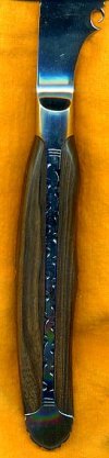

Since you are talking about integrals, I thought you might like to see this one, by Brazilian maker Leandro Pazini, forged from a round 52100 bar, with an horizontal tang and showing extensive filewrok all over it.
Sorry for the ugly scans.
And here is another ugly scan of it.
