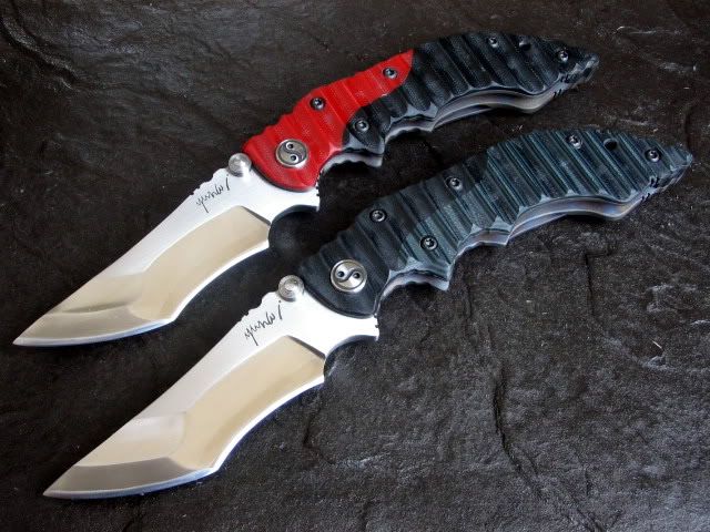

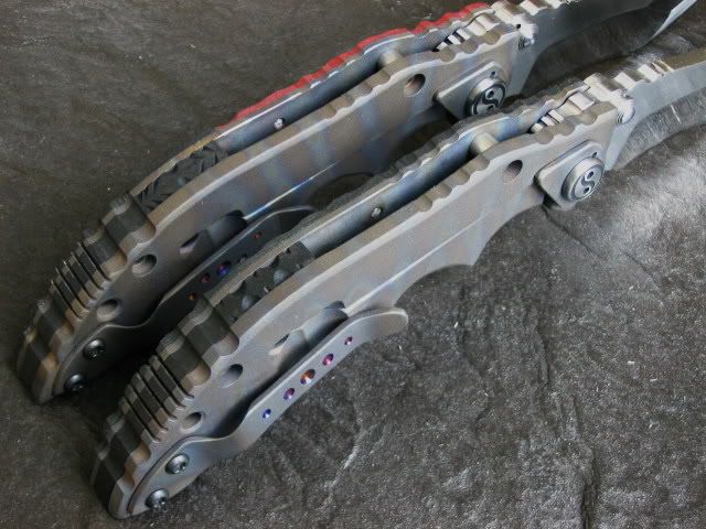

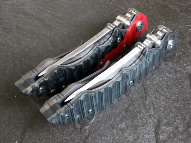

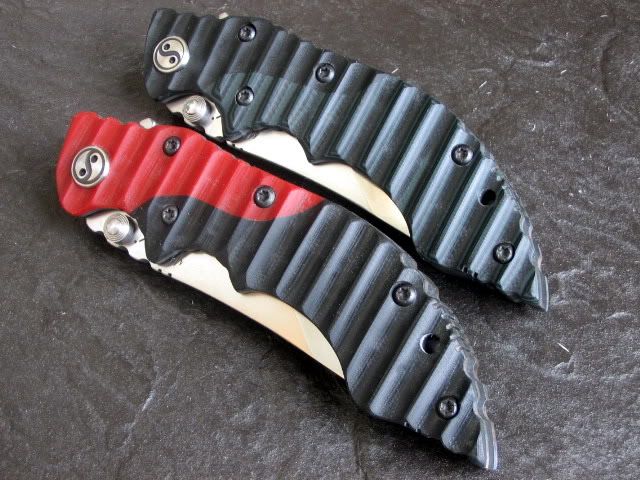

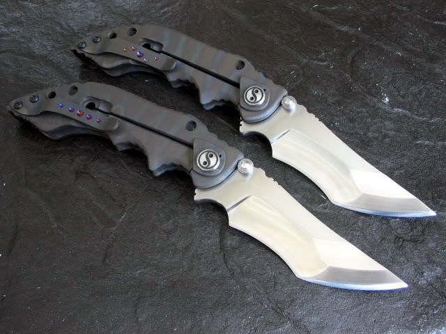

Hi all,
Finished and sent them to Down under. ASSASSIN TYPE S :)
Spec. is :
Blade steel : ZDP-189 which's laminated with ATS-34
Thickness : 5 mm.
Blade length : 3 7/8" from tip to handle
Closed length : 5 5/8"
Opened length : 9 3/8"
Width : 1 3/8"
Grinding : Hollow and Convex
Handle : Red&Black G-10, Black&Black/Green G-10
Frame : 6AL 4V titanium 5 mm. thickness.
Frame stop : 6AL 4V titanium
Spacer : 2 mm. thickness 6AL 4V titanium
Clip : 6AL 4V titanium
Pivot : Hardened 440C in Yin-Yang style.
Thanks for looking :)
YUN
Very stunning knives ! I love how the jimping and filework flow together.
Well done sir ! :)
Tostig
i love the yuna aesthetic. very active and flowing. it's a nice contrast to the more sterile knife styles that seem to predominate the custom world.
Those are some beautiful and tough looking knives. Would not like to come up against those in a fight ...or any knife for that matter, but those would be effective at both slashing and stabbing. Or just impressing others.
