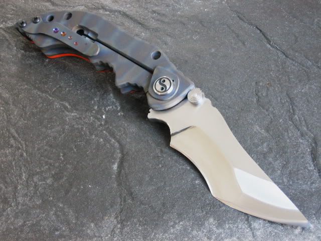

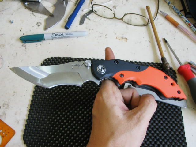

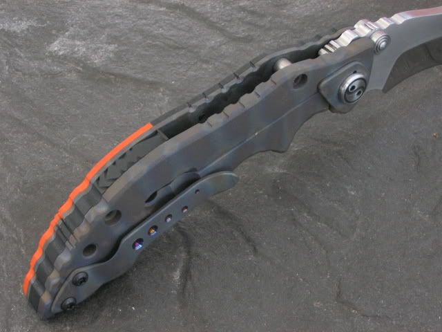

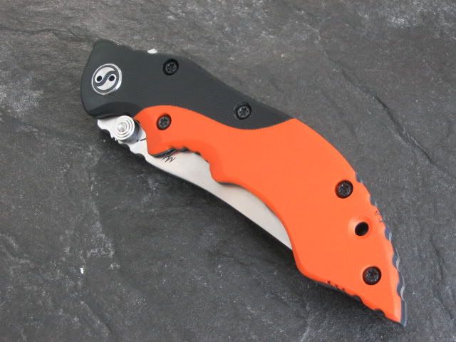

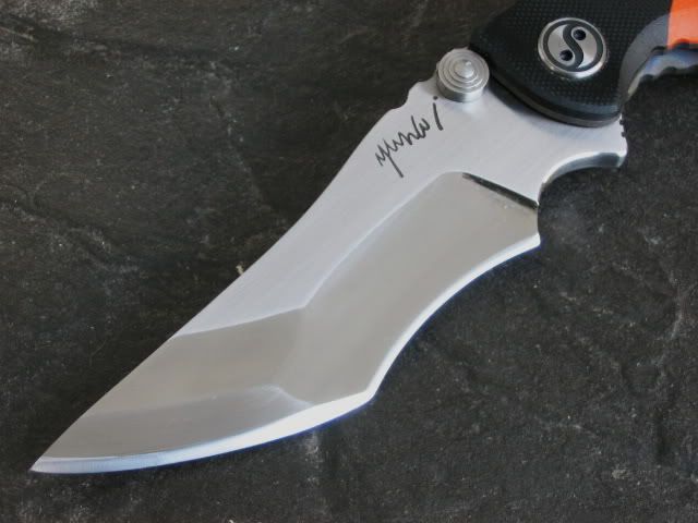

Hi all,
This is custom order from Europe, Steroid Assassin
Spec is:
Blade steel : ZDP-189 which's laminated with ATS-34
Thickness : 5 mm.
Blade length : 4"
Closed length : 5 5/8"
Opened length : 9 3/8"
Width : 1 3/8"
Handle : Black&orange G-10
Frame : 6Al 4V titanium 5 mm. thickness
Spacer, Lock bar stop and Clip : 6Al4V titanium

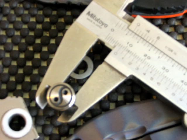

Pivot : Hardened 440C in Yin-Yang style. Shaft dia. is 8 mm.
Thanks for looking
Yun
