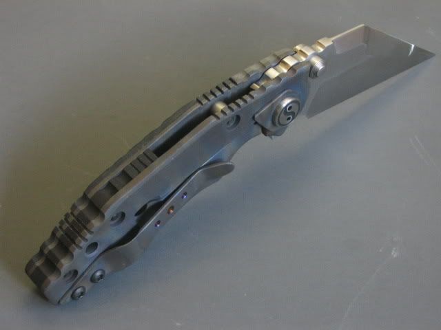

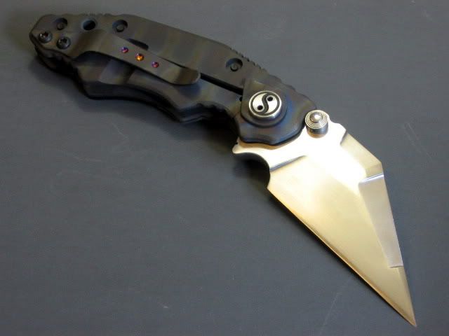

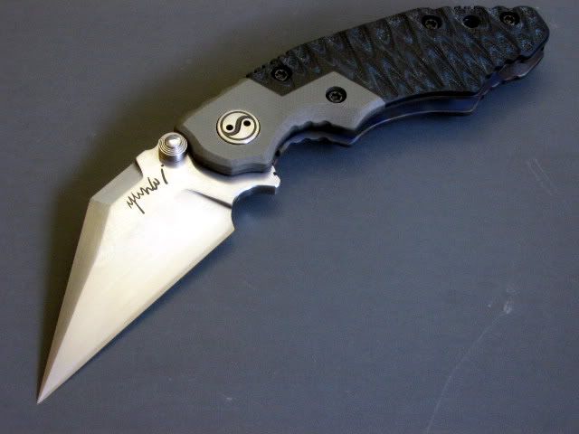

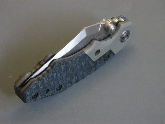

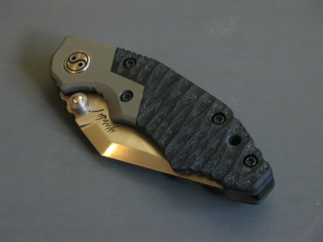

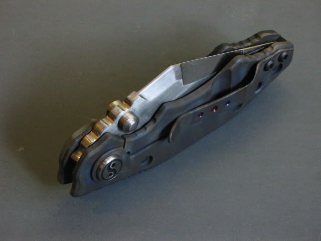

Hi all,
Just finished and sent it to Miami.
This knife is Mini Zombie Slayer.
Spec.
Blade steel : ZDP-189, which 's laminated with ATS-34
Thickness : 4 mm.
Blade length : 3" from tip to handle
Edge length : 2 5/8"
Closed length : 4 1/4"
Opened length : 7 1/4"
Width : 1 3/8"
Handle : Gray&Engraver black/blue G-10
Locking system : Frame lock
Frame : 6AL 4V titanium 1/8"(3 mm.) thickness.
Lock bar stop : carbon fiber or 6AL 4V titanium
Spacer : 1.5 mm. thickness 6AL 4V titanium
Clip : 6AL 4V titanium .
Pivot : Hardened 440C in Yin-Yang style.
Thanks for looking.
Yun
