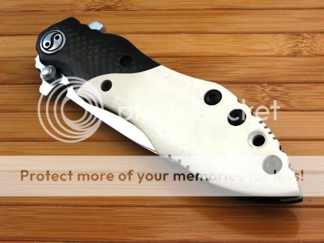

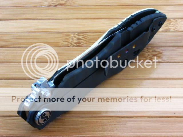

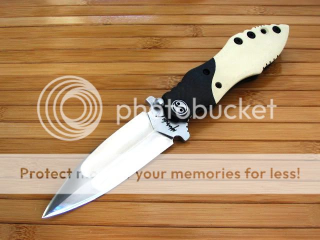

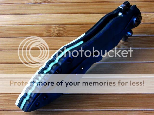

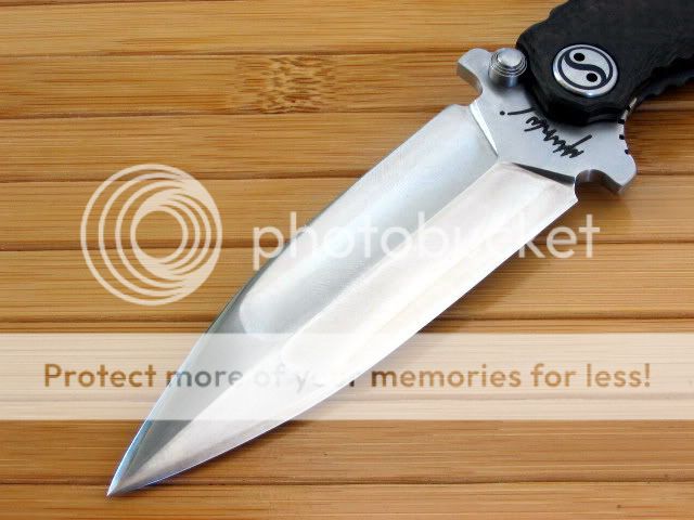

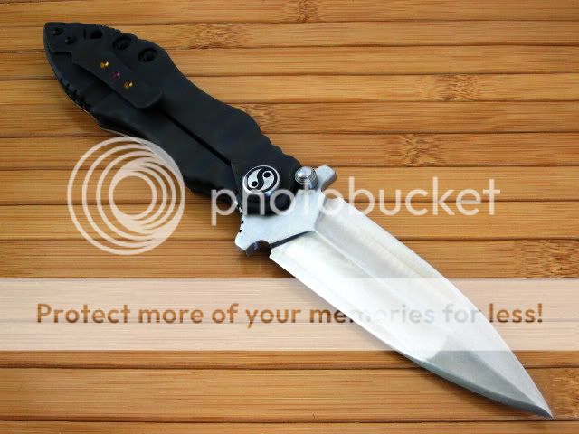

Hi all,
Just finish and sent it to CA!
The first Pran in CF&Ivory micarta handle
I like it a lot. Here is Specs:
Blade steel : VG-10 sanmai 410 stainless steel
Thickness : 4mm.
Blade length : 4 1/4"
Edge length : Bottom edge 3 3/4", Top edge 1 1/8"
Closed length : 5 1/8"
Opened length : 9 3/8"
Width : 1 9/16"
Handle : CF & Ivory micarta
Back spacer : Moon glow.
Frame : 6AL 4V titanium 1/8" thickness.
Frame stop : 6AL 4V titanium
Spacer/ Clip : 6AL 4V titanium
Pivot : Hardened 440C in Yin-Yang style.
Thanks for looking.
