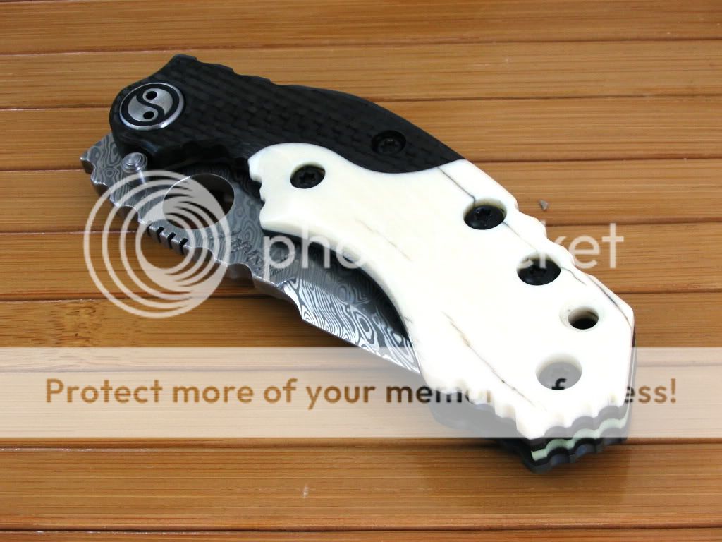

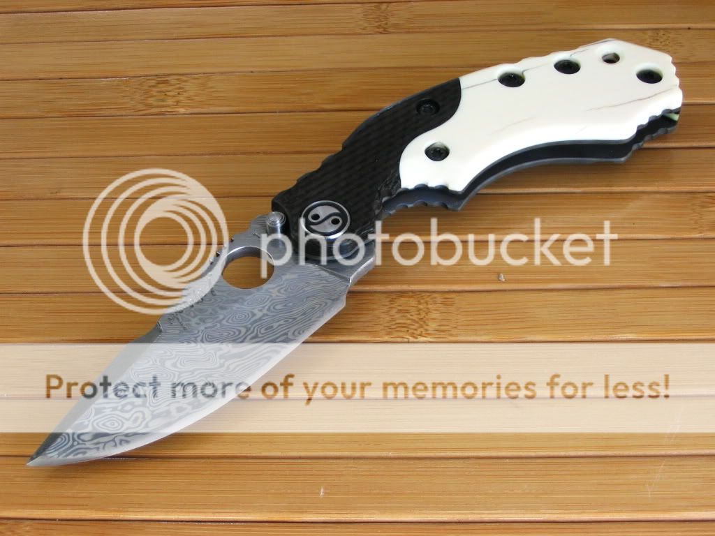

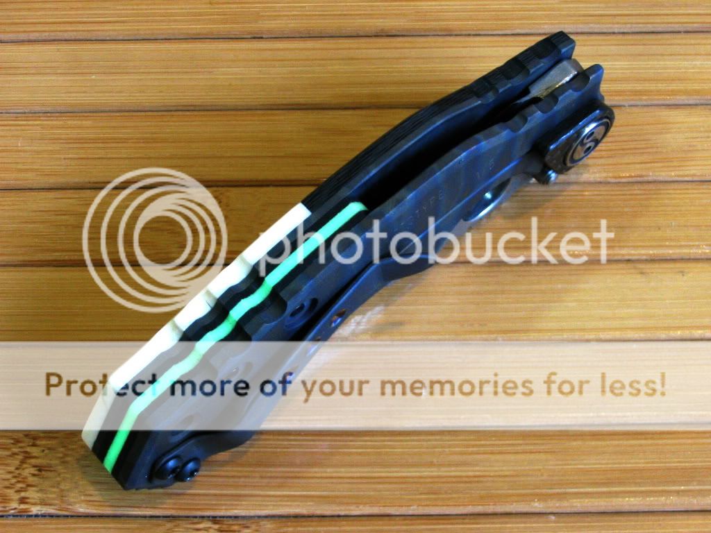

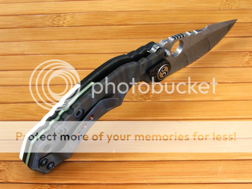

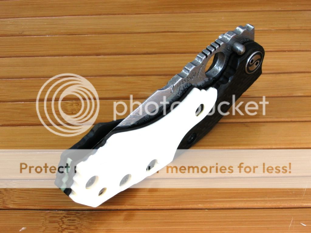

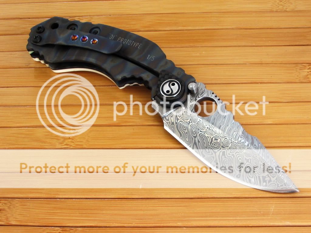

Hi all,
Just finished! OI non flipper Prototype!.
I like it a lot, scary sharp, smooth opening, solid lock and zero blade play!
Specs.
Blade steel : Damasteel
Thickness : 4mm.
Blade length : 3 1/8" from tip to handle
Edge length : 3"
Closed length : 4 1/2"
Opened length : 7 1/2"
Width : 3.3 cms
Handle : Carbon fiber&Elephant ivory
Locking system : Frame lock
Frame : 6AL 4V titanium 1/8" thickness.
Lock bar stop : 6AL 4V titanium
Spacer : 1.5 mm. thickness 6AL 4V titanium
Clip : 6AL 4V titanium
Pivot : Hardened 440C in Yin-Yang style.
