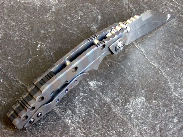

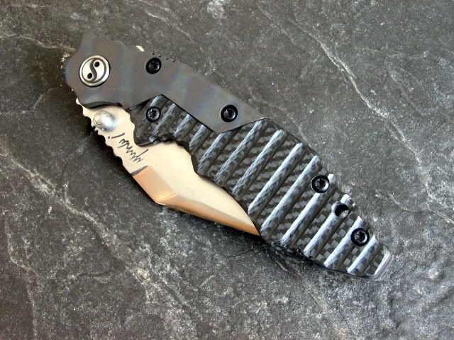

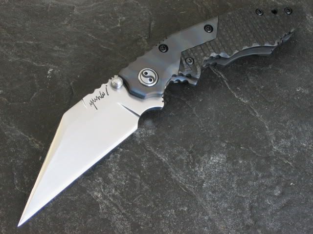

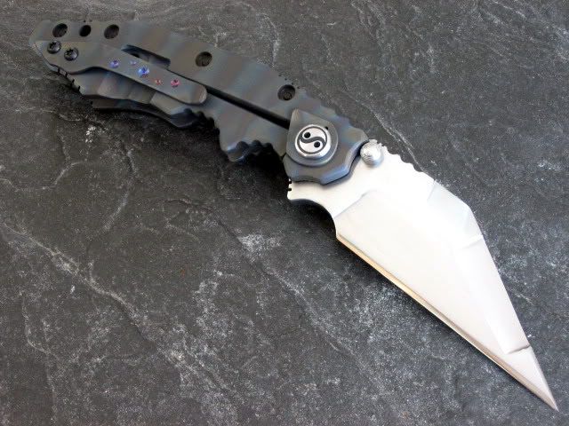

Hi all,
Just finished! This is the custom order from my Thai customer....

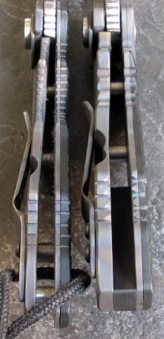

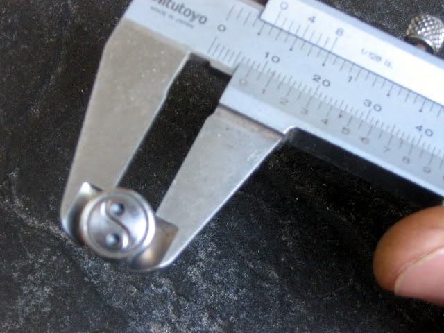

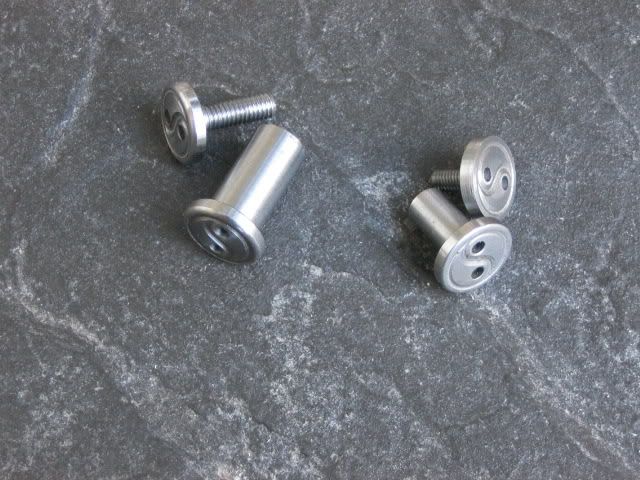

Zombie slayer Type S . For this knife I expand the blade size from 4 mm. thickness to 5 mm., frame from 1/8" thickness to 0.193" thickness, Spacer from 0.063" to 0.08" and Yin- Yang pivot shaft dia. from 6 mm. to 8 mm.
Spec.
Blade steel : ZDP-189, Which's laminated with ATS-34
Thickness : 5 mm.
Blade length : 4"
Closed length : 5 1/8"
Opened length : 9 1/8"
Width : 1 3/8"
Bolster : 1/8" thickness 6AL4Vtitanium
Handle : Grooved carbon fiber
Frame : 6AL 4V titanium 0.193" thickness.
Frame stop : 6AL 4V titanium
Spacer : 0.08"6AL4V titanium
Clip : 6AL 4V titanium
Pivot : Hardened 440C in Yin-Yang style.
Thanks for looking. :D
Yun
I really like the extra thickness on that knife!! Awesome my friend, just awesome!
