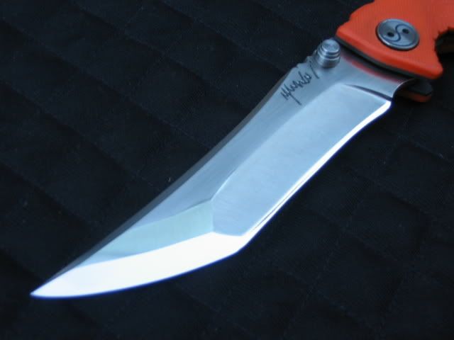

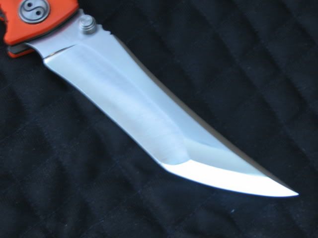

Hi all,
Just finished in last week, the spec is;
Blade length - 4 1/4 " (Satin finished ) and 1/8" thickness.
Opened length - 9 1/2 "
Blade steel - ATS-34, 60.6 Rc.
Grinding - Complex grind, hollow on belly and chisel edge, convex and zero edge on tip.
Handle mat. - Orange G10
Locking system - Liner and very solid
Liner&Spacer - Sand blast 6Al 4V titanium
Pivot - Hardened 440c in Ying-Yang style.
Washer - Teflon ( Smooth opened )
Thumbstud - SUH3 Dual thumbstud
Clip - Heattreated 6AL 4V titanium
Thanks for looking and comments. :) :)
I know it's easy for some guys, I wish I had the money for one of your folders :thumbup: There are exactly the type of folder I like, great handle and blade design!
that is really a very beautiful knife. i really like that complex grind, i wouldn't like to use it myself, but it is really neat.
